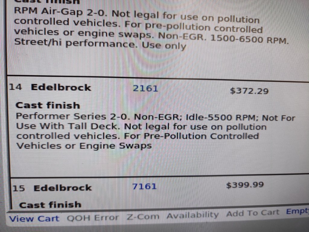

Go on facebook marketplace and search for BBC intake manifold. There's an oval port one down here in Salem for $180. The performer 2.0 is the go-to oval port BBC street intake.

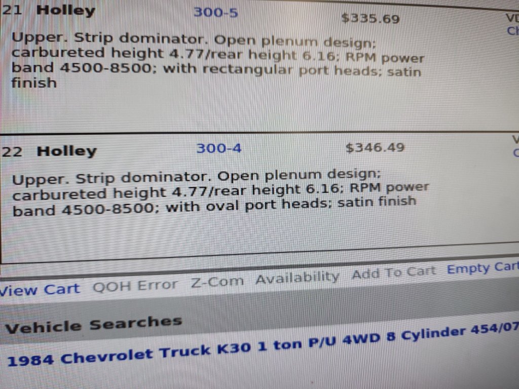

Also, the holley intake part number is on the underside of the manifold. If its a 300-4 it's for a standard deck, oval port. 300-5 is standard deck, rectangular port. I dont know if they make a tall deck strip dominator, but they might.
A standard deck BBC will be 9.8" from crank centerline to cylinder head mounting surface(deck). Tall deck is 10.2".
A block casting number will tell you if it is a tall or standard deck.

Yep, notice the operating RPM band on those. Your holley intake, even if it didn't have a leak, would be killing the low end torque on your peanut port heads. Without significant modifications, the peanut ports are all done by about 4500rpm. The one down here in Salem looks to be the standard Performer 2-0, which is the one you want. If you had car large oval port heads, in a lighter weight car, I would recommend the RPM air-gap manifold.
Did you swap in a different cam? What cam did your motor come with? Where did you get the motor?
