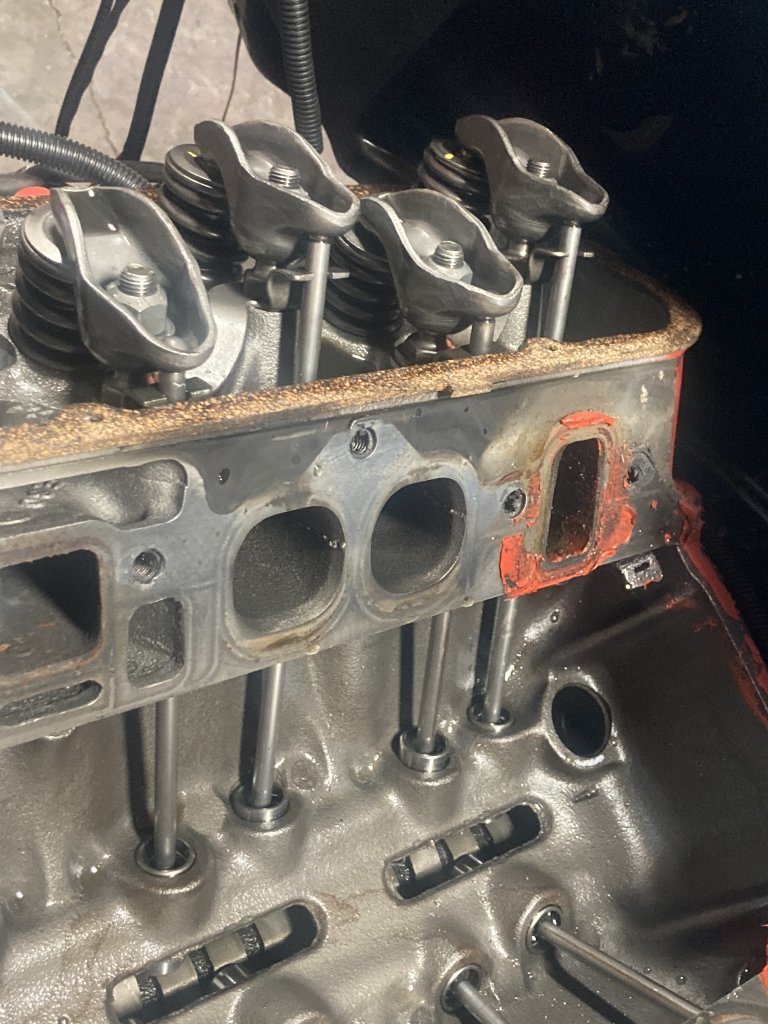

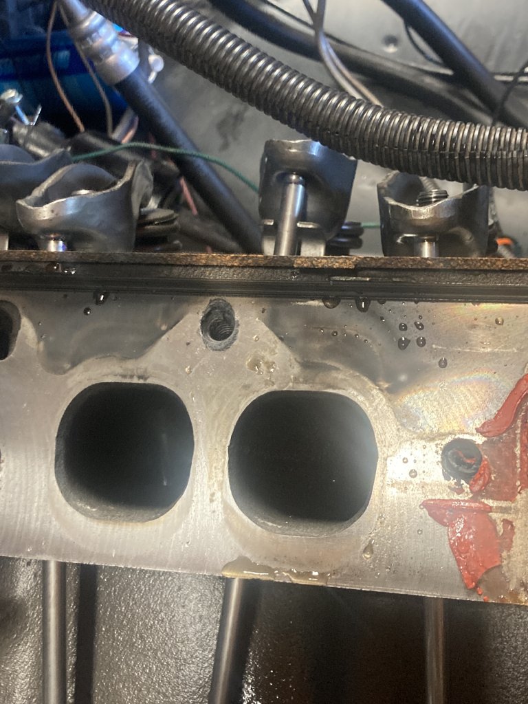

Ok guys ordered the new intake it will be here tomorrow. The intake was definitely my problem it was leaking on almost every one lol take a look for a good laugh. I definitely won’t make this mistake again

Here is for learning purposes for anyone doing a new build. First don’t trust parts stores check then double check. Then triple check and that’s all I got now here is for another good laugh
wow, you can see how much higher the rectangle ports went by the witness marks above the round ports... do you have a pic of the intake manifold flange and the gasket you were using too by chance?

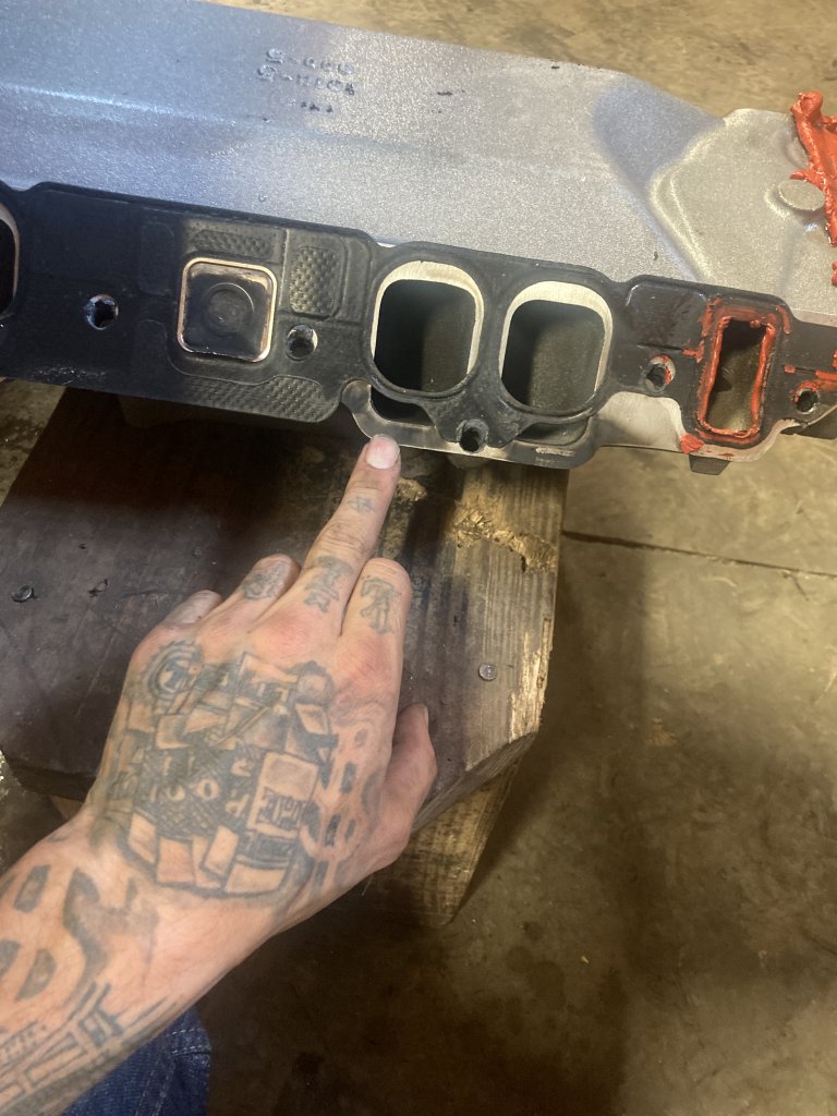

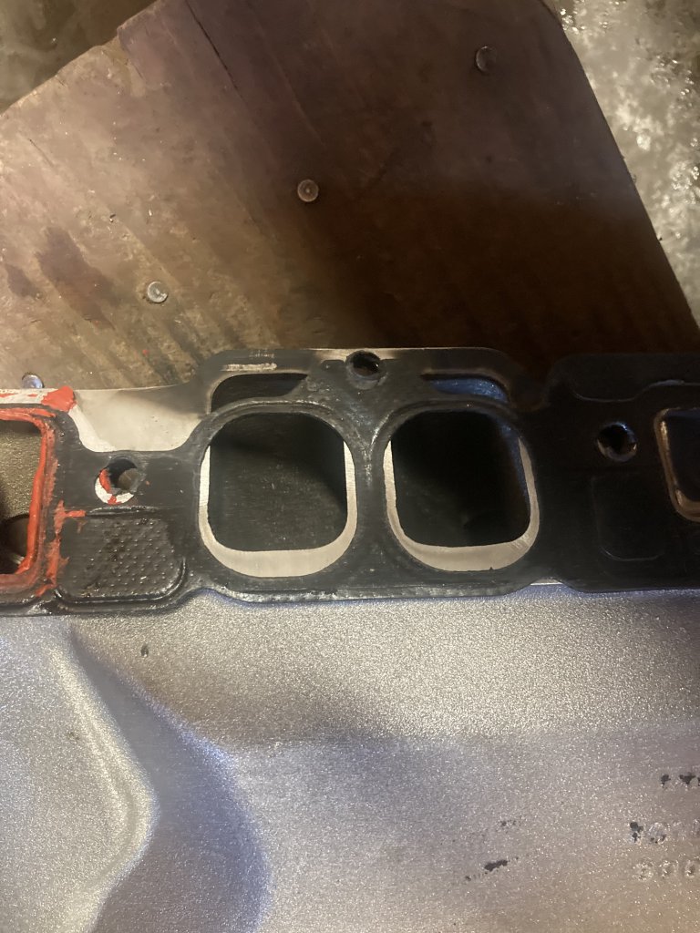

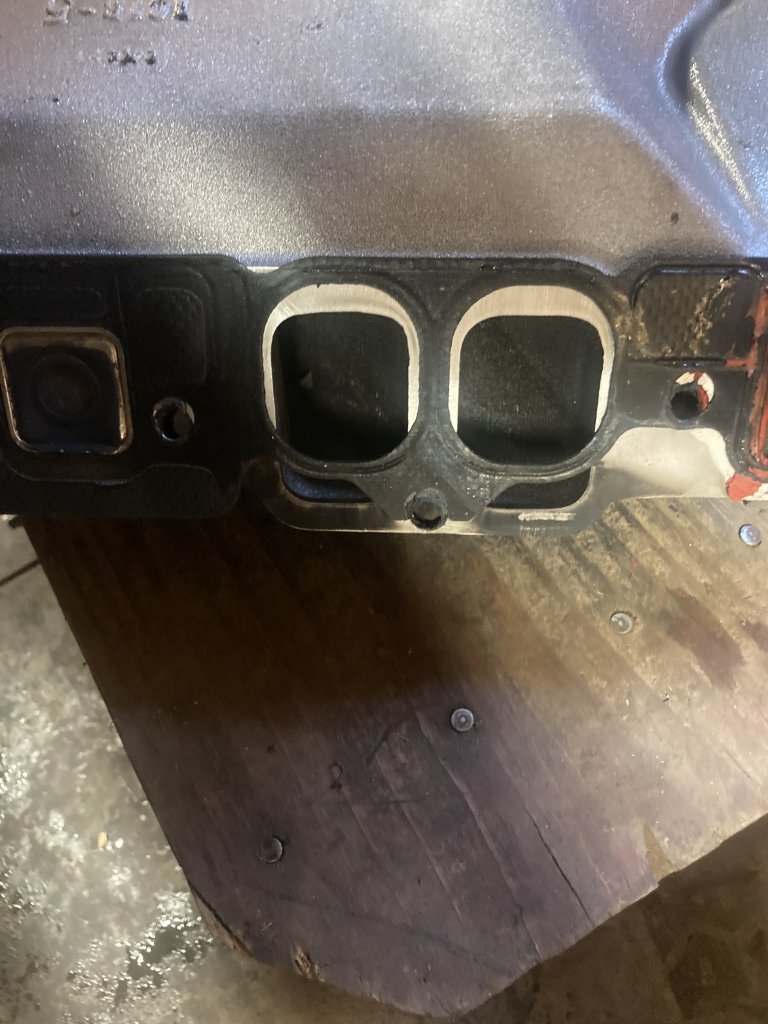

What I did was set my gasket on the head and was like hell that looks good. And didn’t think twice to check on the intake. I feel so stupid.
wow, I had no idea the rectangle port sat that much higher on the cylinder head than the ovals... that's crazy! You can definitely see why they make so much more power at high RPM though. That was a crazy amount of vacuum leak
I’m surprised it even fired off. Funny thing is that when I first fired the truck it was back firing and shooting fireballs out the carb. And I was like wtf it has to be 180 deg out so I ended up bring it to comp stroke Tdc probably 3 different times checked then rechecked my plug wires. Idk how it even fired. I can’t wait to see the difference in how it runs vs when it was messed up
