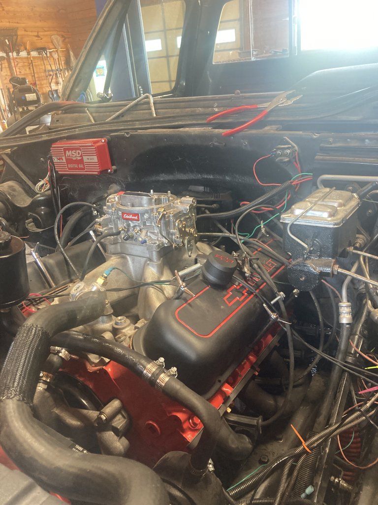

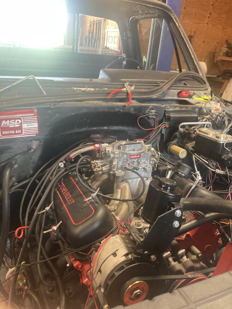

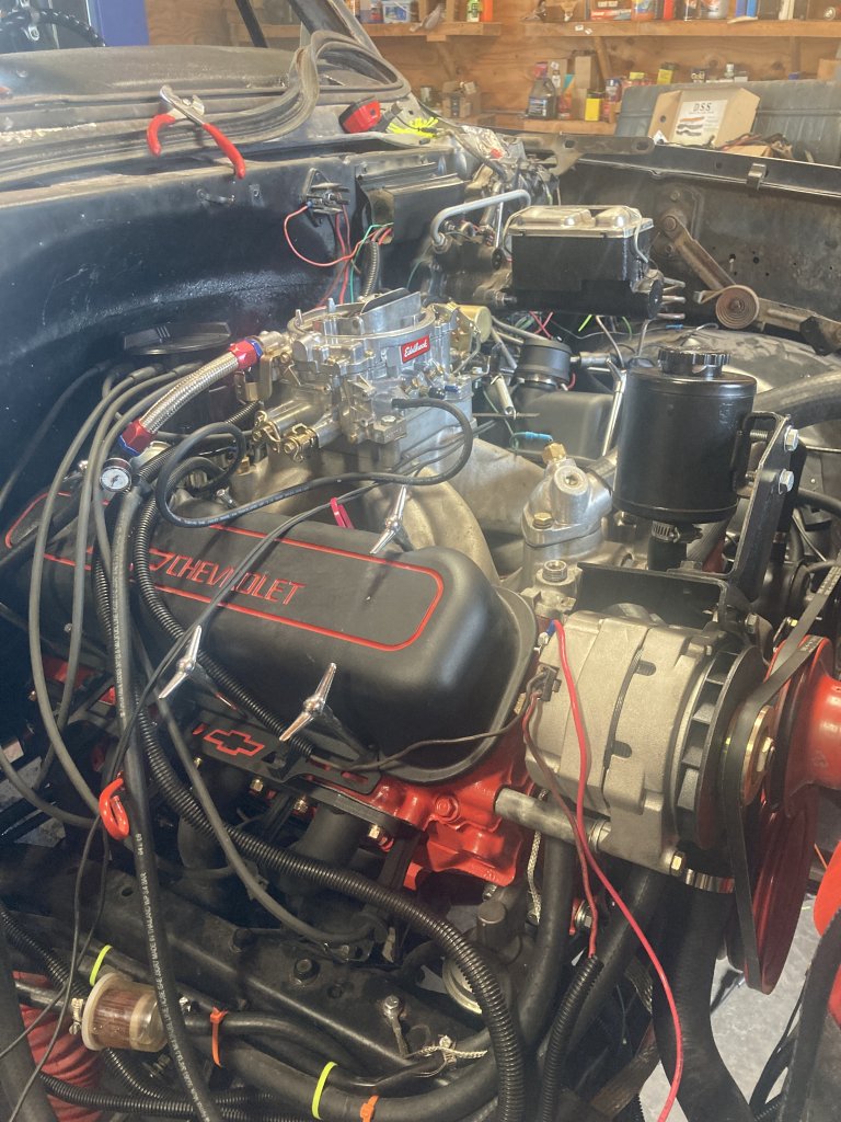

This is the motor

Ignore msd I decided to not use it
