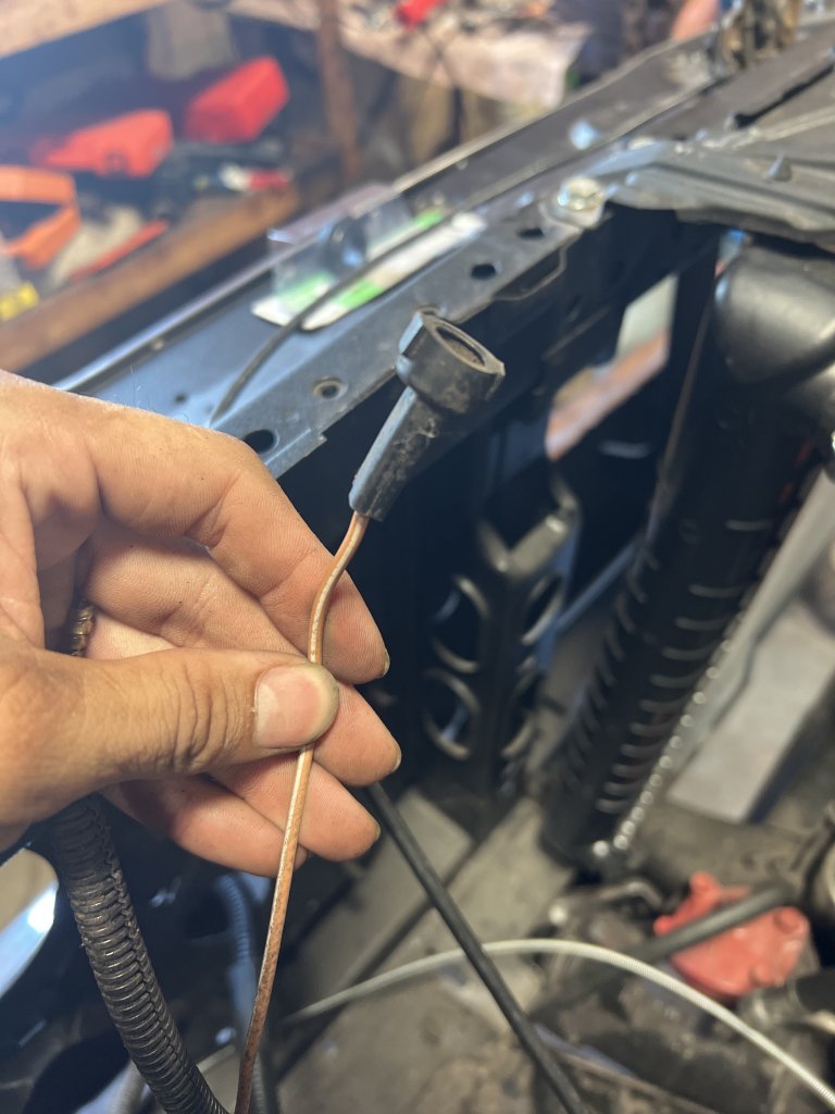

Wtf does this go to it comes of my headlight wiring harness

At first glance that looks like the connector for your Proportioning Valve. It should be behind the front frame rail just off center towards the drivers' side.

My proportioning valve has a prong not a flat blade like the connector? Still it ya think?

Mine is the same way. If your brake like is not on, hook a jumper up to the connector to ground and check again. If the brake light is still not on, it's something else.
