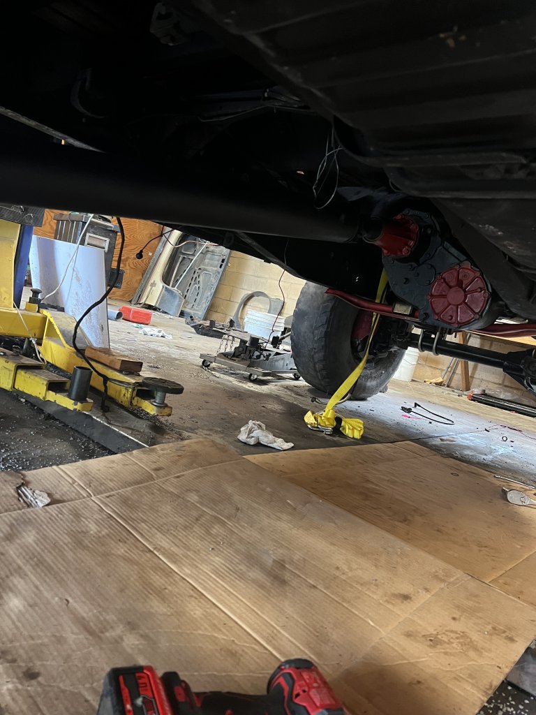

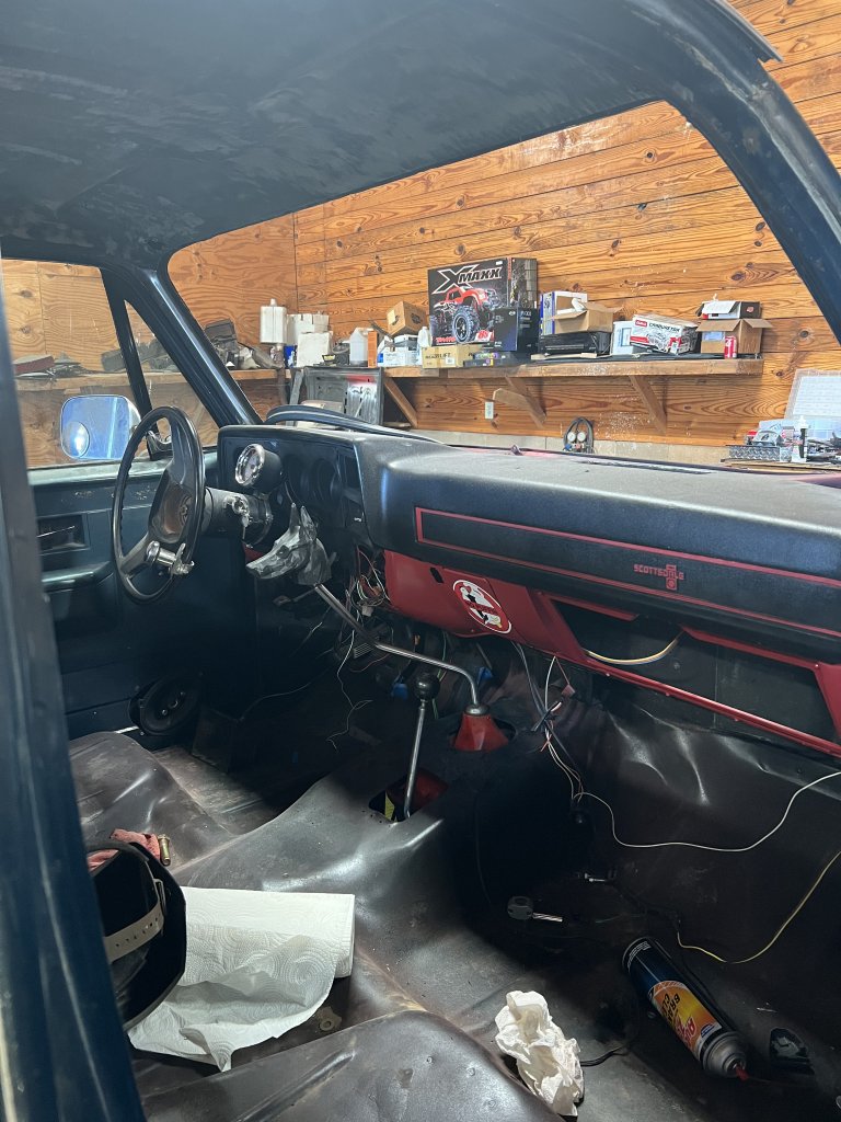

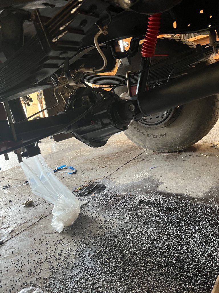

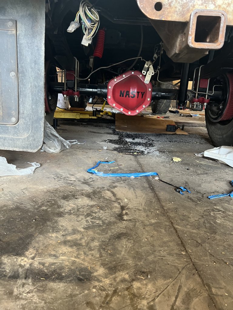

Well guys just thought ide keep everyone posted I got the drivetrain done and the interior started and it’s all falling in place.

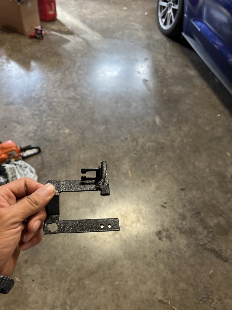

No I just made a bracket for the throttle cable and return spring
Is the throttle return spring actually hooked up in these pictures?
