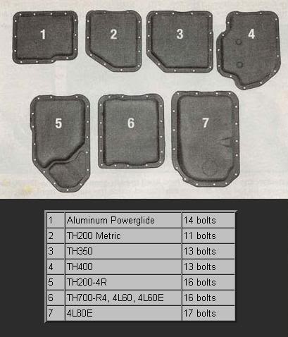

The only transmission option code for the 400ci that year was M40 so unless it has been swapped out it's a TH400. Check the pan to verify.
@skysurfer - Was that for a Blazer or a Pickup? I have owned a pickup that had a factory 400, TH350, NP203. Could you please post a link that I can check into that?
I'm not doubting your information, I just want to be 100% sure that I know what I'm buying before I hook up the trailer and put on the miles

That info is specific to the '76 Blazer. PM sent so you can double check.

To my surprise, it appears that this particular Blazer has the factory 400/TH400 with the Z82 package. It certainly paid off doing a bit of investigation beforehand. Mid 1977 appears to be the last run of the TH400 behind a small block in a 1500 series truck with the exception of having the "Trailering Special" Z82 package, however I could be wrong without some more in-depth research.
