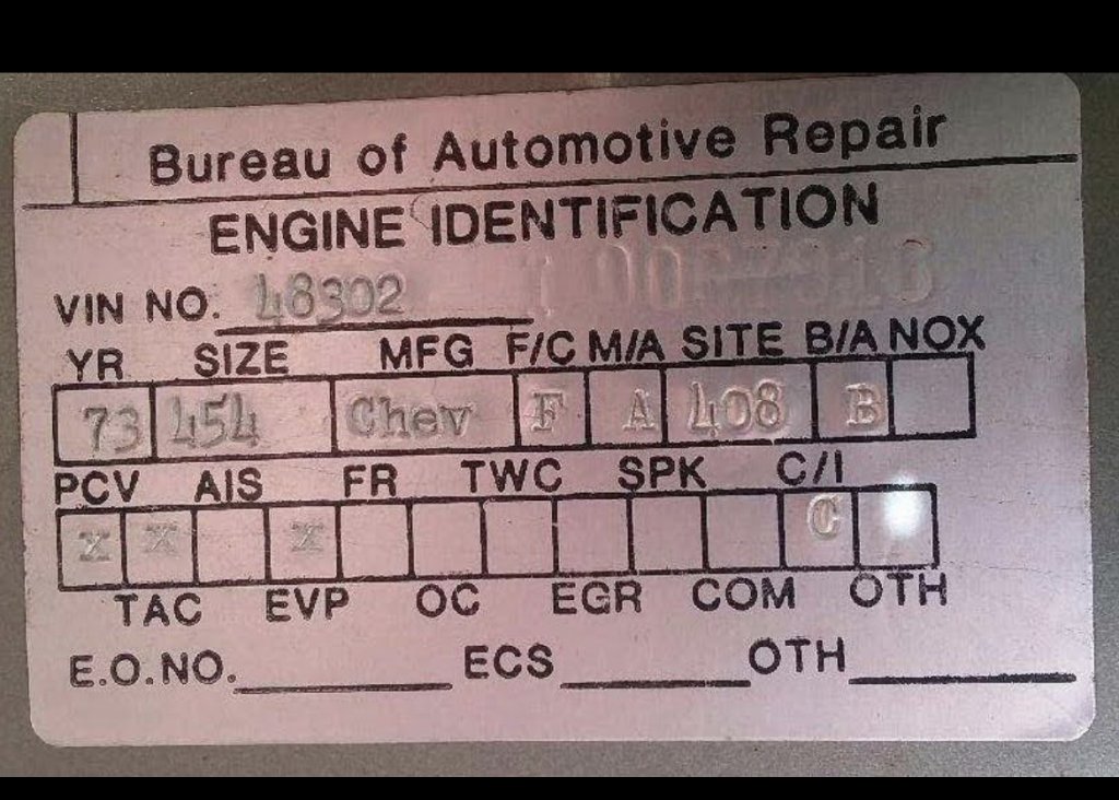

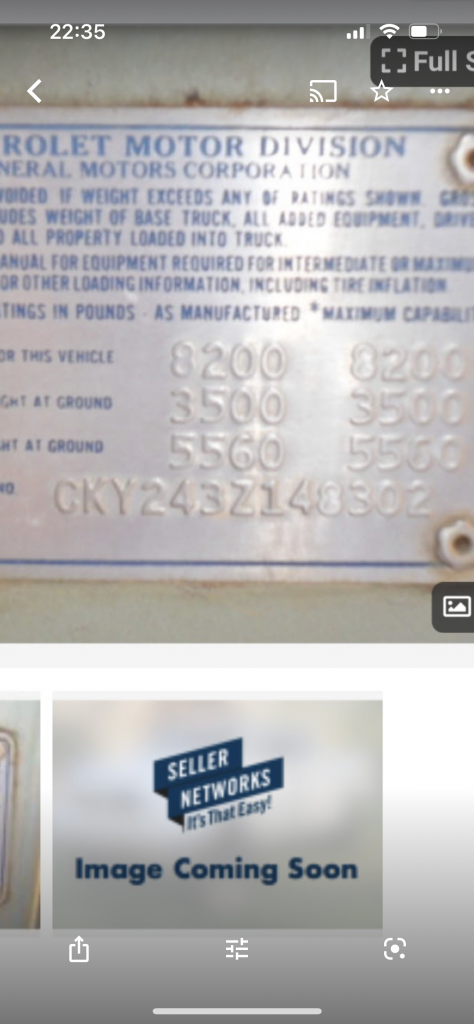

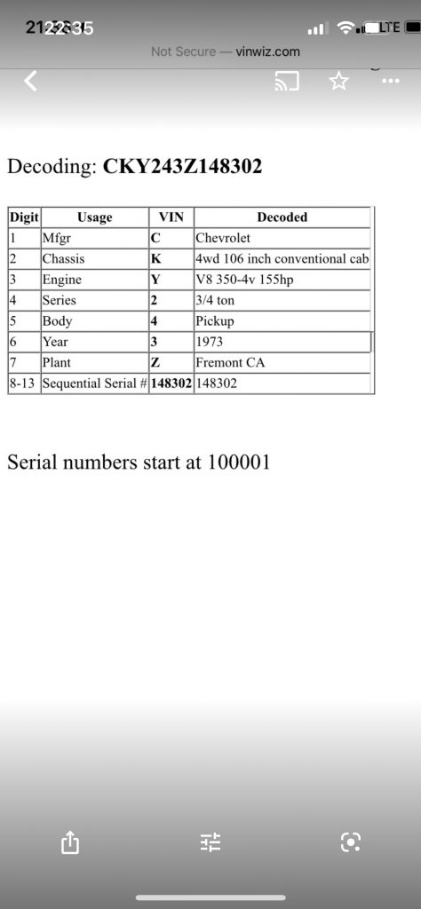

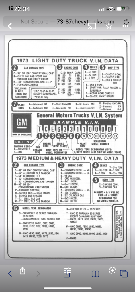

I just bought a 1973 Chevy K20 Camper Special. However, there’s 2 conflicting items with the VIN that have me scratching my head. I was hoping an old head from CA that really knows Camper Specials or early year square bodies might know:

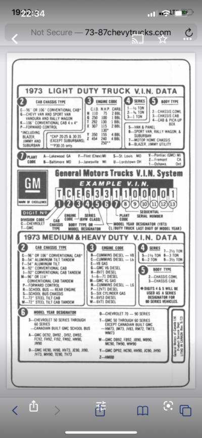

1) The VIN is CKY243Z148302. The “Y” denotes that a 350 engine should be in the truck, however, there is a 454 in it. Interestingly enough, there is a sticker on the truck frame from the California Bureau of Automotive Repair verifying the 454 engine. I’m wondering if the manufacturer took a built/“completed” truck with a 350 engine and then did the engine switch to upgrade the truck to the 454/Camper Special package for a customer? And therefore had to get it “re verified” by the CA BAR because it was technically an engine change? Was the camper special ever offered with a 350?

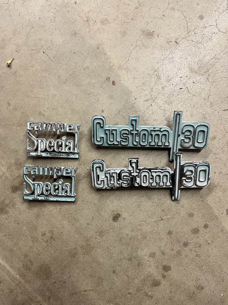

2) The VIN also denotes a “2” (or K20) However, there were “Custom 30” badges on the truck when I got it. Is there a plausible reason the VIN would indicate a 20 series (3/4 ton) but then the truck would have been badged as a “30” because it’s a camper special? Or is it more likely that someone put the wrong badges on this truck during its life?

The date code/casting #'s of the engine will give you an idea of which came first. Were 454's available in 1973?

Based on the info I’ve found, the 454 was not an option for 3/4 ton 4WD in 1973. Looks like you might have an engine transplant, and they even got it approved by the emissions board.
Even the 400 engine was not an option until ‘75.

The previous owner was under the impression the 454 was part of the camper special package. I see what you both are saying now, it doesn’t look like it was offered in 73– which completely changes my concept of the history of the truck. I just googled where to find the engine codes on the block. I will find them and update.

You've done your homework; your interpretation of the VIN is correct.
My vote would be that someone put the wrong badges on the fenders at some point in it's life (even as far as back as the assembly plant).

The frames and front diff would be different between a 3/4 and 1 ton. You can measure the height of the frame and also see what front diff you have. If its a K30, you would have a Dana 60 front and the frame is(I think) 7-1/2" tall compared to around 6" tall on a 3/4 ton.

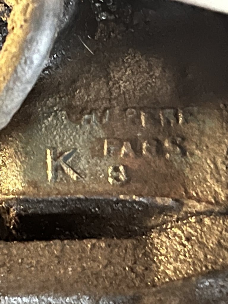

also PS for others that were kind enough to reply- the only thing i could get to on my own was a stamp on the drivers side- which according to my googling - shows me the engine is from a passenger car! I have a friend coming over saturday to help me get the diff off to access the block numbers.
That doesn't mean anything. You need the stamped number in the flat spot above the timing cover on the front of the engine or on the flat spot right in front of the passenger side cylinder head. You can also get some useful data from the block and cylinder head casting numbers and dates.

thank you! i’m itching to get some help this weekend with taking some stuff off to see all these #s.
You can see the stamping numbers without removing anything. Just get a wire brush on the flats and some brake cleaner to get the junk off them. Same with the block casting numbers, they should all be visible without removing anything.
The only thing you will need to remove to see casting numbers is the valve covers to see what cylinder heads you have. Check both sides, because it has been known to happen that people will swap out just a single head if they have issues.
