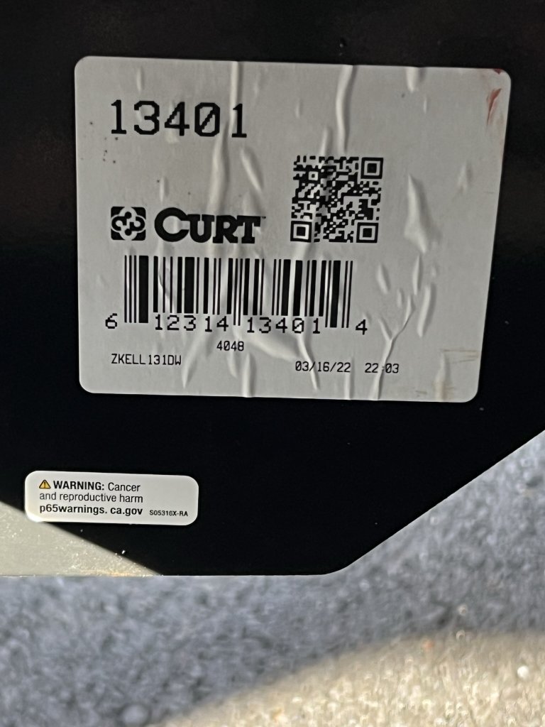

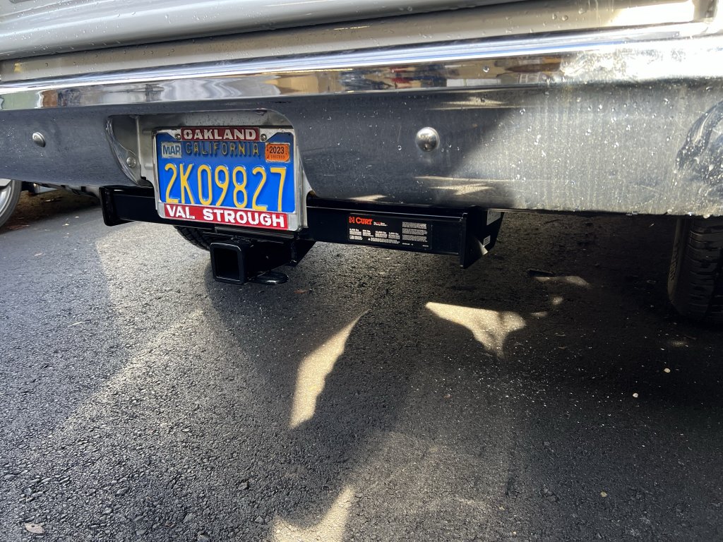

Success at last! Post after post and ordering a reciever that was supposed to fit, l ordered a reciever they said wouldn’t fit! Anyway, happy happy happy!!!
FYI:

Good job I knew you'd find one that fit!
