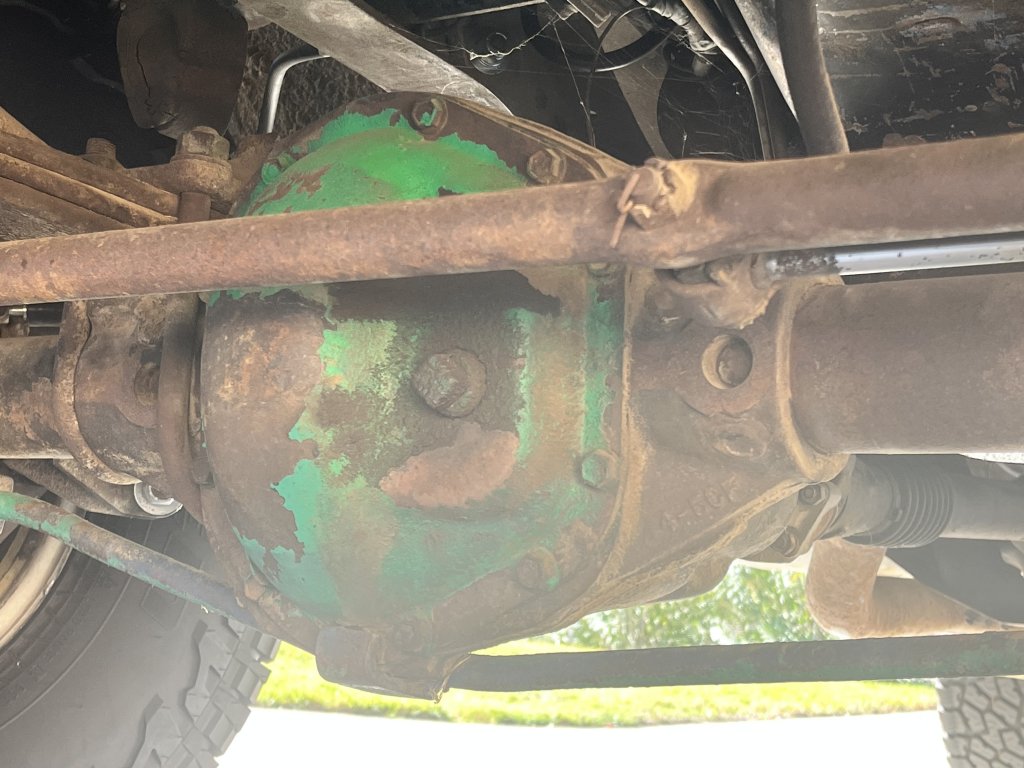

You've done your homework; your interpretation of the VIN is correct.
My vote would be that someone put the wrong badges on the fenders at some point in it's life (even as far as back as the assembly plant).
Fremont was not known for it's stellar build quality back in the late 60's or early 70's.
K
Keith! On my ongoing quest to figure out if this is a K20 or K30: I assumed it was a 3/4 ton with the wrong badging since the VIN has a “2”. But my google homework told me to look at the front diff to see if it’s a 44 or 60 to tell the difference. It looks like a 60 to me? (please disregard the goofy green paint from the PO). So 30 badging, 30 front axle, but a 20 VIN? what in the same hill is going on here? Camper Specials are weird.
