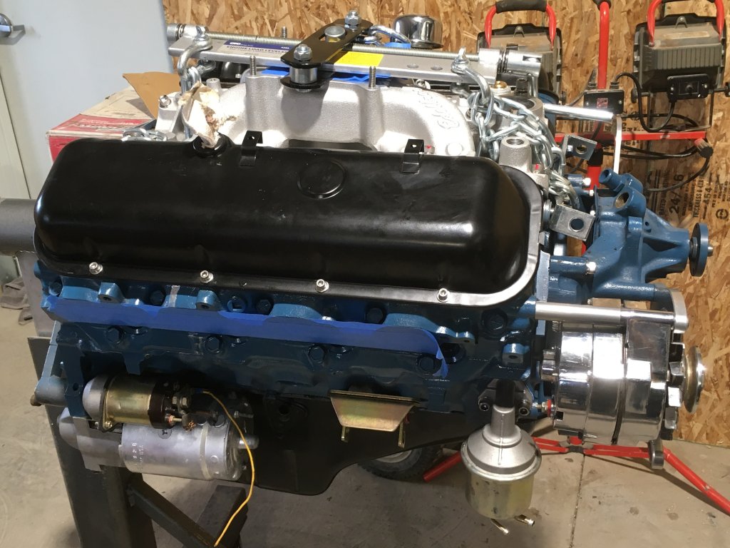

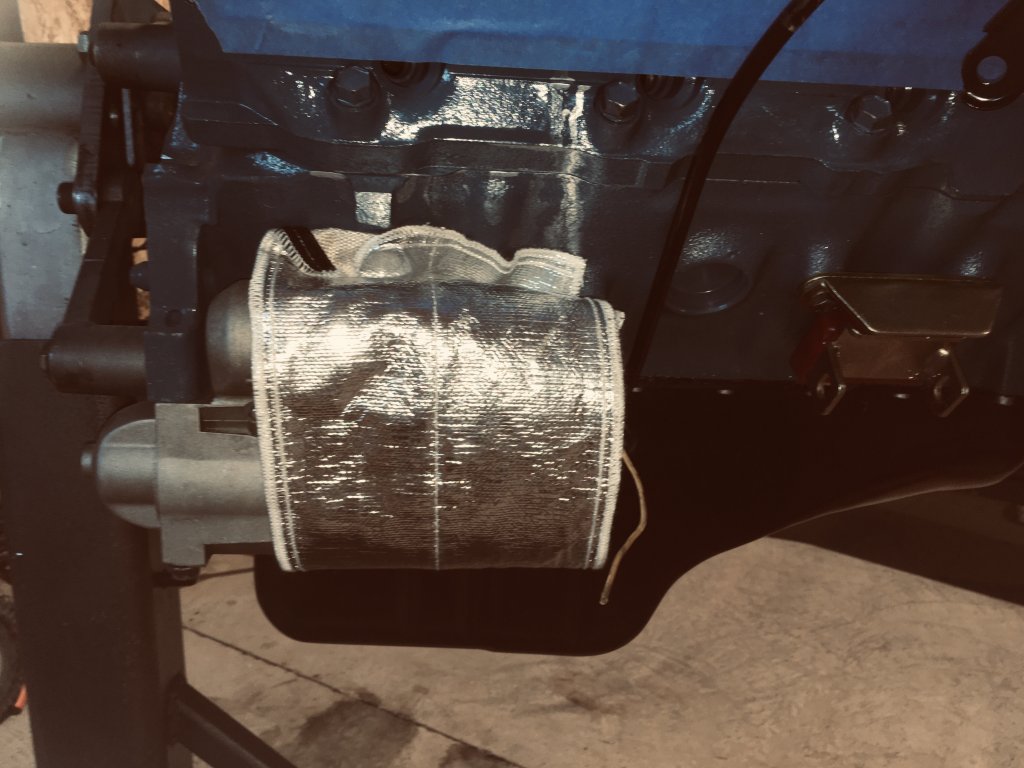

My stock started, with headers BBC 454, the wrap did help, bit will probably go with a high torque minnie as at times the starter is a little slow on very hot days, or if I start it up after it has sat and heat soaked a few minutes.

I recommend using header wrap. It made a huge difference in my under hood temperature
