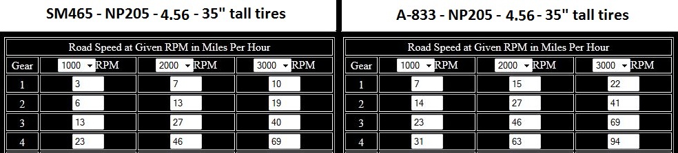

Thanks C4. Have you noticed the gap in the SM465 from 2nd to 3, which typically people drive as 1st and 2nd is actually even bigger than the gap on the A833? Appears that 3rd in the SM465 is about identical to 2nd in the A833 and of course 4th and 3rd are identical.
Cruising 94mph with 4.56's @3000 rpm. Jep, I can handle that !!! :waytogo:

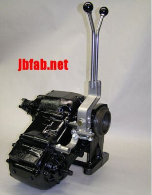

And I sure like the idea of twinstick NP205. I don't have the OEM plastic shifter cover and boots anyway and I know will be hard to find and expensive, so I'd rather just spend the funds on that set up on the twin stick. I think I'll like have 2hi & 2lo Rear Drive only, 2hi & 2lo Front Drive only, and 4hi & 4lo of course then N. Twin sticking an NP205 gives you 7 different shift poistions, 6 drive options and Neutral.
I'm hoping to get this guy to mod this set up my application. I don't think these sticks will clear that long adapter of this trans, so the rodd will need to be a bit closer to straight, but this guy here seems to have a nice twin stick set up for $146 on eBay and it's stainless steel and comes with nice looking twin stick boot. I don't want anything looking Jerry rigged.
