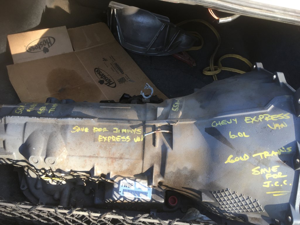

Identifying Year of Production
Identifying the year of production is important for a variety of reasons including fitment and compatibility for swaps, internal hard part replacement, computer calibration and programming and others. GM provides two methods for determining what year and application a given 4L80E was manufactured. The first is the large date stamp sticker on the raised rectangular embossment on the passenger side of the case, below the cooler line area. It contains a 4-character alpha-numeric code that informs the year and application of the vehicle. The second method is using the metal ID tag secured to the rear passenger side of the case via a rivet. It will have a three-character code along with other information that provides year and application.
ID tag and sticker - 1995 unit (left) and ID tag and sticker - 2006 unit (right)
Number = Year of production (distinguish between 1990s and 2000s via the presence or absence of a bell housing bolt hole location at the 12-o’clock position.
Alpha-3 Digit Code = Application (model, sub-model)
GM Goodwrench Remanufactured Units: These units replaced the OEM factory tag and stamp with a GM Goodwrench green ID tag and sticker which is typically placed onto the bell housing
