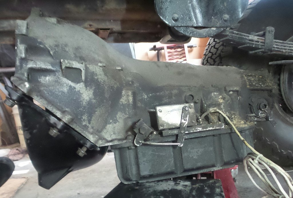

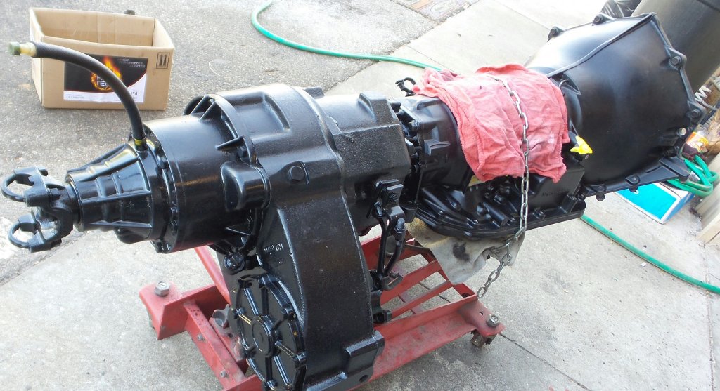

I was wondering if anyone has used a four speed Hydramatic trans and tossed the turbo 350/400 from their truck?
I did just that ..
dragstews
GMC-IH
Mar 27, 2024
628
2,297
Belleview Florida US of A
Jesse
Body 1954, frame 1975
R-100
406 ci SBC
Have you had a chance to drive it? How's it working out?
Still working on the installation ...
Not a Plug & Play deal for a 4x4 ..
Shafts, crossmember, column shift lever pivot bracket and dealing with making a mount up to relocate the NP203 shifter ..
Two wheel drive is much less complicated ...
