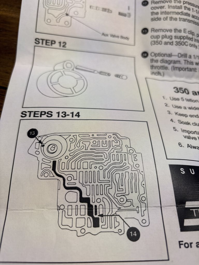

There a part in the instructions that is optional to drill a 1/16 hole to prevent loss of converter lube during heavy throttle. I’ve install shift kits before but have never heard of this step, does anyone have any insight to this modification ? That would be step 14 in pics provided.

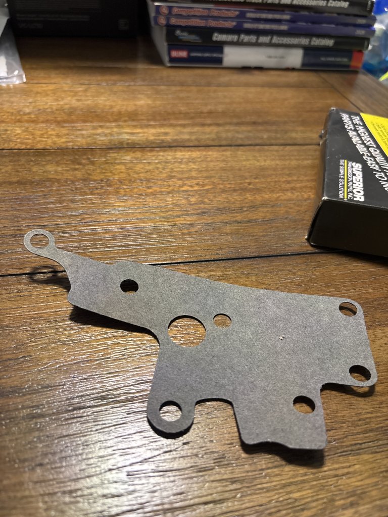

Last there is a gasket supplied to be installed between separator plate and spacer support plate. Would this gasket supplied be equivalent to dual feed also ??

Here are pics of questioned gasket and optional step with the superior kit
