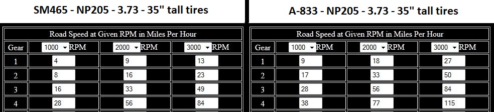

This chart shows the basic speed differences between the SM465 and the A-833...
attachment.php
I've got speed/rpm calculators, but I don't have that chart format C4. Can I get you to do another one just like that, but with 4.56 gears? :High 5:
This chart is pretty cool, although a bit misleading. You have to consider 2nd gear of the SM465 is actually 1st on the A833, then 4th on the SM465 is actually 3rd on the A833. I still like both transmission, and think NV4500 is a great trans too, but for the money I stole this trans for, and it came with the Hurst Shifter already mounted I couldn't beat it. I'd like to have just kept the 700r4, but I don't have faith in it over the long haul of taking abuse, and I'd prefer a manual trans for off-roading anyway, always have. I've always been a through and through manual trans guy, but go figure, I can build automatics for dirt cheap and they are a dime a dozen and easy to find as cores. I truely miss my M22 transmission shifting days, and this trans other than the ratios being wider, it fits the bill, and being a side quick shifting Hurst shifter, and the facts it's an OEM option, it all comes together to be a great project and I'm dying to get it together. The other thing is, since plans now changed just to go NP205, and make it my stornger 4x4 with the 3/4 ton axles truck, I'm not going to be as concerned about cosmetics on this build. As long as it looks sanitary, I'm good, becasue I expect it get scratched up and dinged up, and maybe even dented up.
