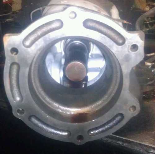

So to get the Round 86 up NP205 to bolt to this trans, I'll need this:
attachment.php
To look like this: (This being a pic of an adapter off of a Th400 to round NP205)
attachment.php

You only have to do that maching for the bigger bearing if you're converting one from a 27 spline shaft to the 32 spline shaft. The Round Pattern Tcase for a Th400 will only need to have the short short female input shaft swapped into it if I don't cut the shaft off in the trans. I'm now leaning more toward the short shaft swap.

If I don't cut the output shaft, here's the gear I'd need for the round NP205 when I find it. Notice it does say, after 85, which 86 is the round untis, GM standardized to the long one. I need the short if I don't cut the trans output shaft.
$246 at Advance Adapters
http://www.advanceadapters.com/products/32-spline-np205-input-gear--bearing/
$135 at Off-Road Design
http://offroaddesign.com/catalog/transfercaseparts.htm
I was going to say, there's no need to buy an entire t-case to get the correct input.
...and son of a bitch! Why couldn't they have had that input and bearing kit a few years ago?! Would have saved me a bit of trouble.

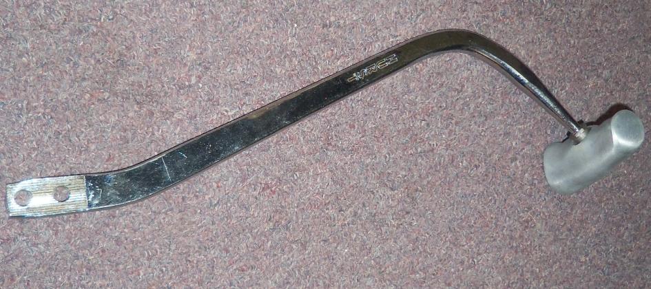

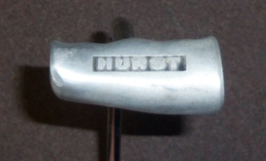

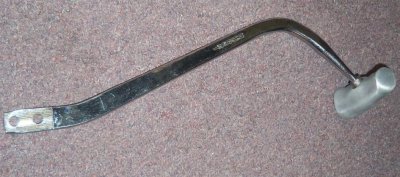

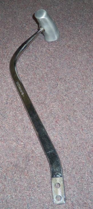

Still being patient on this project keeping eyes open for an NP208 or NP205 that I can rock with it. Still have to find clutch and brake pedals too, so no hurry. I'd also like to rebuild the trans with a new counter shaft, new bearings, new synchros and gaskets. Kinda thinking about a hipo clutch too, but also thinking for 4x4ing, and not drag racing, OEM clutch should be fine. I also want to rebuild the OEM Hurst shfiter. I can send the shifter back to Hurst and they make it like new again for $300. I figured to hell with that, I can buy a new Hurst Competition Plus shifter for that, which is very similar to what I have on this trans OEM, just that the Aftermarket Hurst Comp Plus has adjustable stops for the gates and a bolt on removeable shift stick feature for changing out the stick for different vehicles. I think I found a place I can get a rebuild kit for this shifter for $100, and I'll likely do that, AFTER I get it all installed and working properly and make sure I can use my old stick. I might hit the dash in a square.
attachment.php
Which brings me to the purpose of this post. When rebuilding this OEM shifter, I do hope to be able to retrofit the shifter with the Comp Plus type bolt on shift stick assembly where as now it's a fixed type that uses roll pins and isn't really intended for the OEM stick to come out of it. But, I went digging deep into the shed today and thinking I did save my T handle from my old race days with the M21 and M22 for a keepsake. BAMM !!! I found it. And then I remember, when I sold that shifter, the guy was putting it in a Nova, and I had a Indy short stick I gave him with the shifter and I kept my shift stick too. So I actually have the stick and the T handle from my race days in the 80's and early 90's. Guys, I'm telling you, if this thing could take, the stories it could tell. From racing to women, it wouldn't shut up for a month telling stories. I think it would be awesome to be able to use this on this transmission if and when I get it running. It still won't be the same as my Muncies, but it'll be nice nonetheless and bring back many many fun memories. It's a bit scratched up from heavy use, but I'm gonna polish the stick and get it nice looking again. Not gonna polish the brushed aluminum T handle to a shine, I want it left the way I used it, just gonna clean it up.
