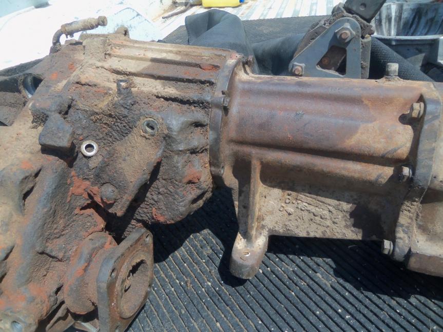

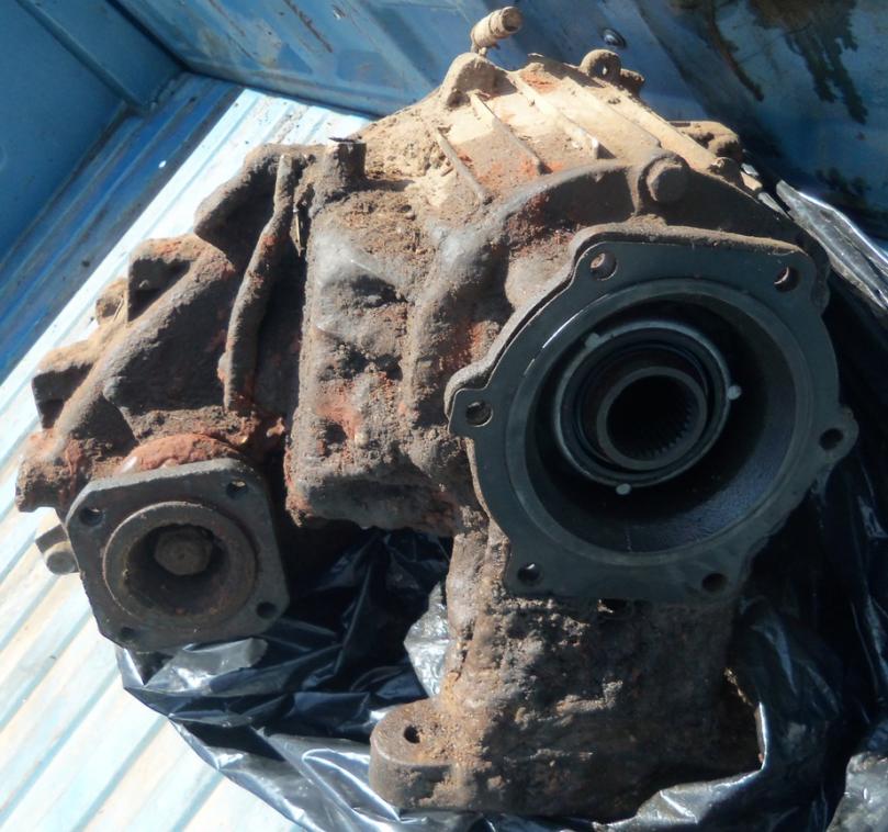

So to get some cash, I listed one of my 3 NP208's for 700r4/Th350 on CL for $100. A guy come to look at it today, and wasn't sure it was the right one. I assured him it is. He said he has a NP208 but it's the wrong one. It don't look right cuz it's Octagon shape. I'm thinking Th400 and 32 spline the whole time, about to pop wood right there in front of a grown man about to make myself look gay as hell. Then I told him, damn I wish we knew for sure, cuz if you have the one I think it is, I'd swap you and I showed him the A833. He said, NO, that won't fit, you need round and this one is Octagon. I told him, it probably has a Th400 adapter on it, and it if does, that means it's 32 spline, and I take that adapter off and it's what I need. THEN HE SAYS, well I have it with me !!! :eek: :manos: We go look and BINGO !!! I said, man, if you don't need that, I'll swap you straight up and let you keep your shift rod and speedo driven gear assembly. He said, OK !!! So that's how it's done. Now I have a Tcase for the NP A833. Filthy dirty outside, but the fluid looks great, the bearings and chain seem tight. I might throw a seal kit in it when I do the A833. So that means, all I need now is clutch linkage as in pedals and hydros and I'll be rocking the 4 speed OD with Hurts Shifter !!!
THIS IS HOW WE DO IT !!! .....
From this:
attachment.php
To this: No Funds even mentioned !!!
attachment.php
crazy4offroad
Equal Opportunity Destroyer
8,501
1,205
West BY-GOD Virginia
Curt
K-10
350/SM465/NP205

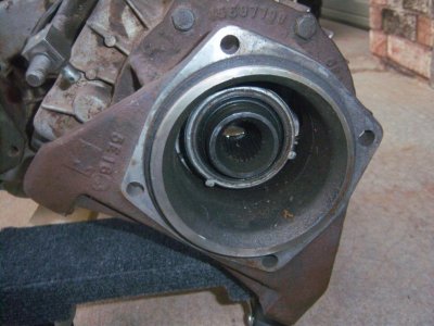

You sure that's gonna work? Just looking at the grimy side behind the adapter it looks like a round 6 bolt pattern. It's definitely 32-spline / fine spline on the adapter. If nothing else you have the input shaft you need now. I hope it's the right one, I wanna see this setup in action!!
47,859
11,038

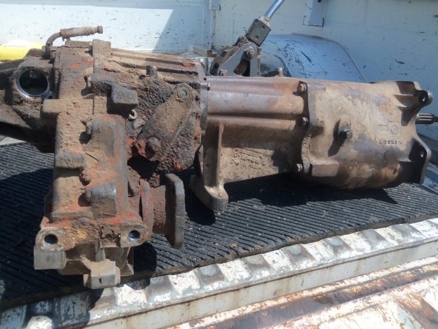

Am I sure it's gonna work??......
We are gathered here today, to Join this A833 with this NP208 in holy matromony......
I know pronounce you husband and wife, A833, you can kiss your transfer case bride !!!

PERFECT! Now, clean that couple up and paint them FFS, they're filthy!! :lol:
47,859
11,038
Yep, I'm sure it'll work !!! I knew it would. All those ramblings up there for 7 pages, was a whole lotta looking around and diggin for info. This transfer case being dated 12/83, I'm going to assume is out of a CUCV. Wasn't it until after 86 that OEM Th400s started getting NP208's instead of NP205's??? Or am I getting confused with something else again???
