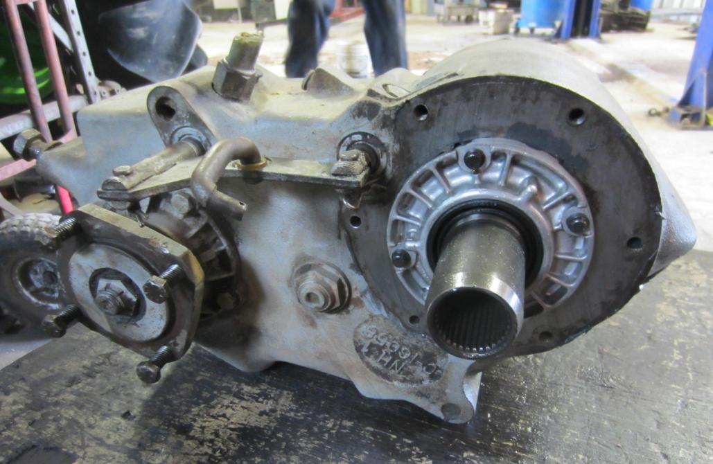

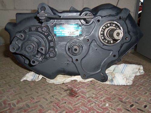

Pic #1 is round pattern, Th400 splines,
attachment.php
Pic #2 is Racetrack Pattern Th350 splines.
attachment.php
47,859
11,038
HeYYYYYYYYYYY, I'm lying. Look close at the Round Pattern. I just knew it could be fuggin done. That round WAS a racetrack at one time. Someone redrilled holes and filled holes and converted it to round.
attachment.php
i must be blind cause i dont see any plugged holes circle them for us

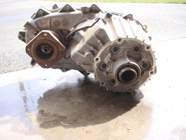

So this is what the NP208 WITH the Th400 adapter bolted to it looks like.
attachment.php
This is what the NP208 Looks like in the Round pattern, the only way a NP208 comes, looks WITHOUT that adapter.
attachment.php
Which bolts to the back of the A833 that has it's adapter built into the tailshaft.
attachment.php
Once Pic #2 above is bolted to Pic #3 above, it then looks like this.
attachment.php
And to get a NP205 bolted to the A833 adapter, I'll have to notch Pic #3 above in this post, to look like this and use a ROUND NP205 since the Racetrack as pictured above won't bolt up.
attachment.php
I guess you're right, and there isn't enough meat on the upper portion either. I just see the racetrack pattern is still there just not used.
