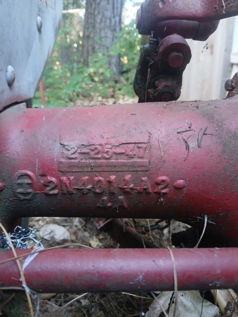

Here's the 2. That's ones close to the home lol on the engine the code says it was born March 5th 1947
Nice! It even has the pto cover still.

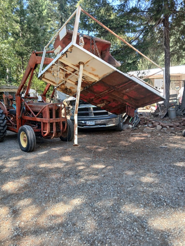

The 2n sits because it has #1 dead cylinder. Found these of the power master doing what it does. I use this tractor allot.
