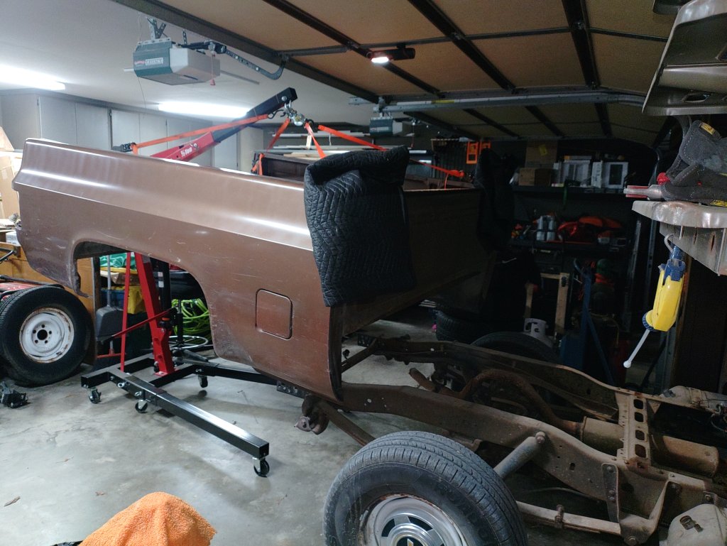

Pulled the box 1 man style getting ready for a C-notch and flip with CalTracs. Any recommendations on a budget friendly rust converter and paint for topcoat? Happy Saturday!

Do the flip and see where she lands mine did not need a C notch which works for me as I'd rather not chop up the frame. Just ground down the rivets and knocked the bump stop brackets off. However, I don't haul stuff with mine so there's never any weight in the bed other than the 20-gallon fuel cell. Also, under a hard launch/acceleration even a burn out using the line lock she separates due to the CalTracs.
POR 15 and Eastwood seem to be the most popular rust inhibitors.

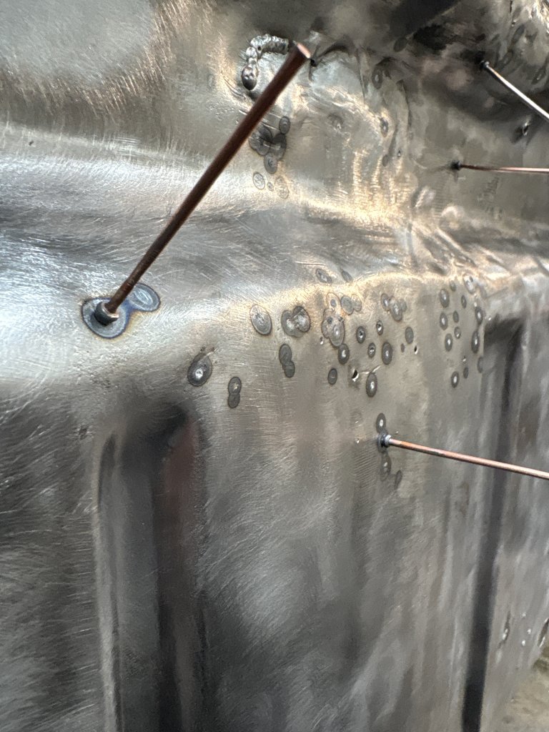

Starting to think adhd/ocd are a bad combination to have - should I continue with the cab floor dings or just stop and finish with metal prep:banghead:
