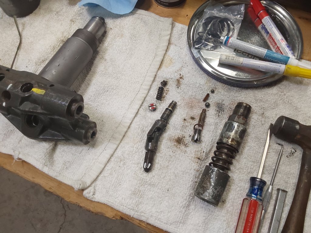

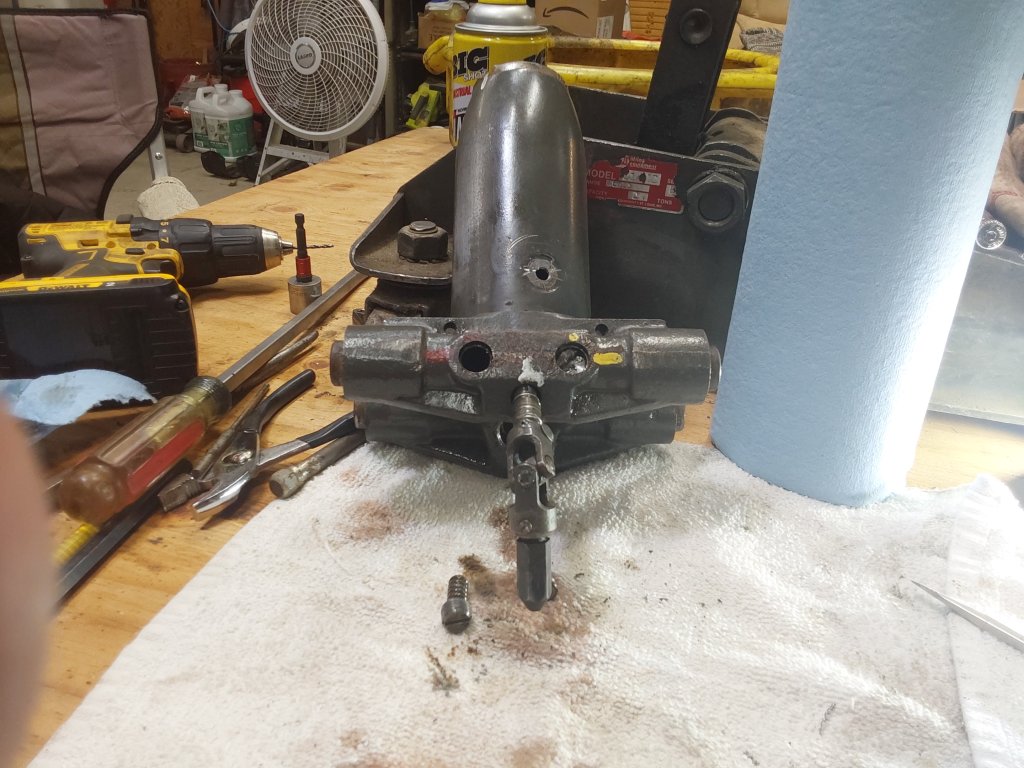

Waiting for my new steering box,so doing a rebuild on my Napa floor jack

Thanks but I have a craftsman 2 ton as well, it bleeds off so it will be my next one when I get time
