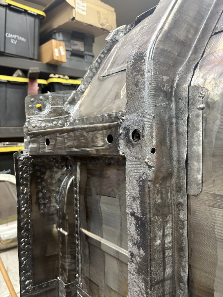

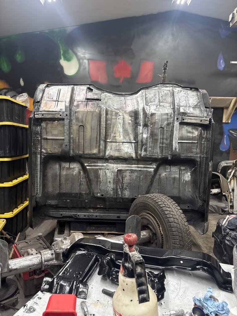

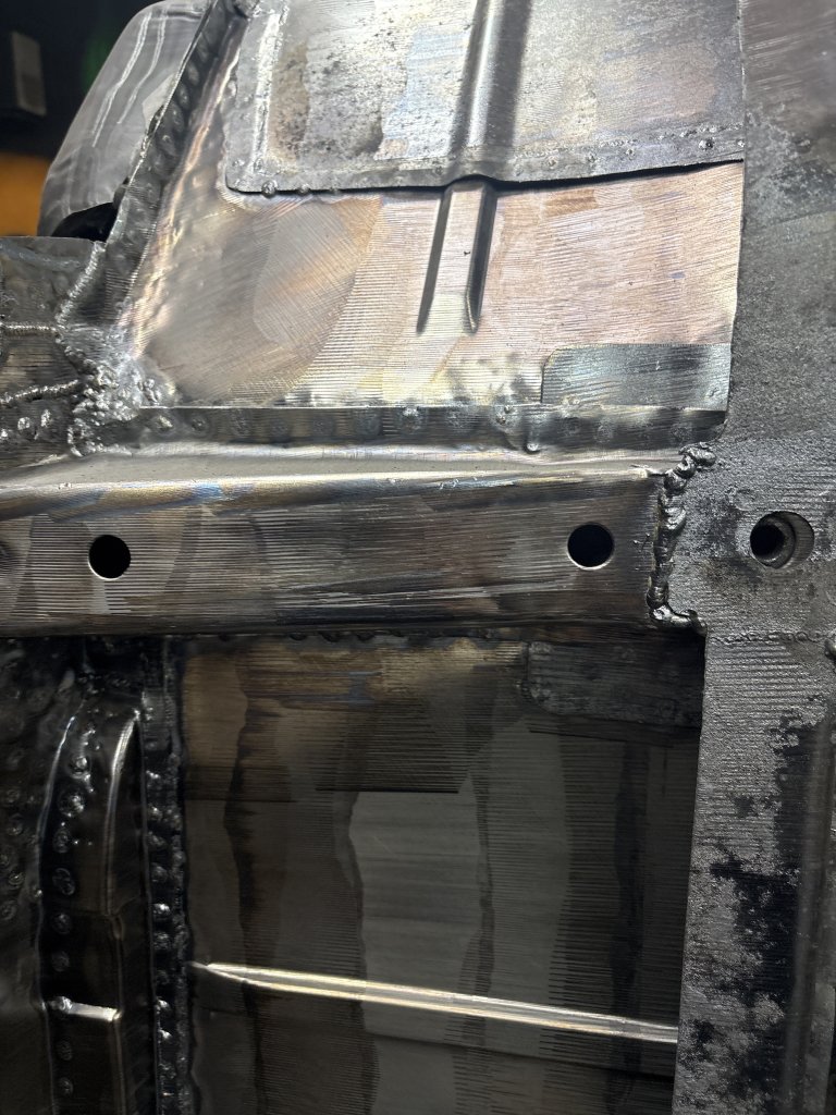

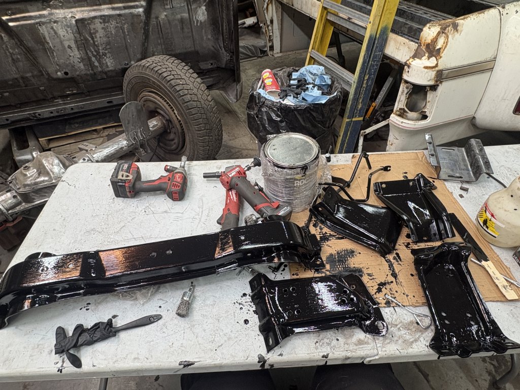

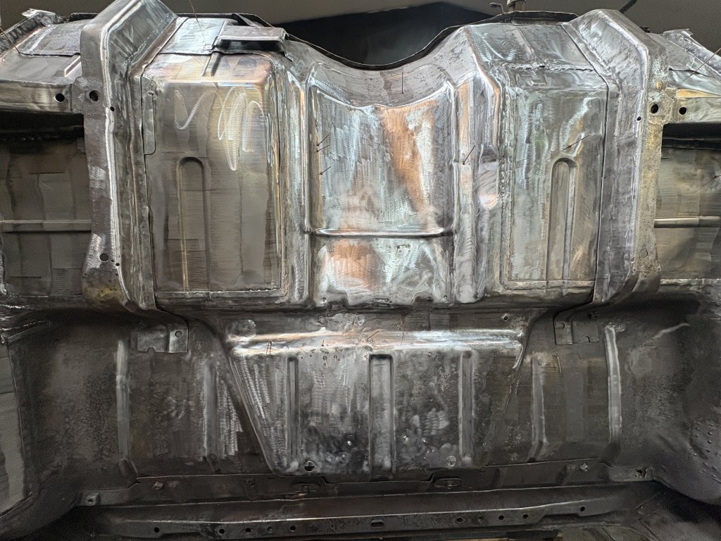

Started the weekend getting the mill scale off - leftovers from lasering, cleaning off residual tight spot rust it couldn’t reach, good weekend!
