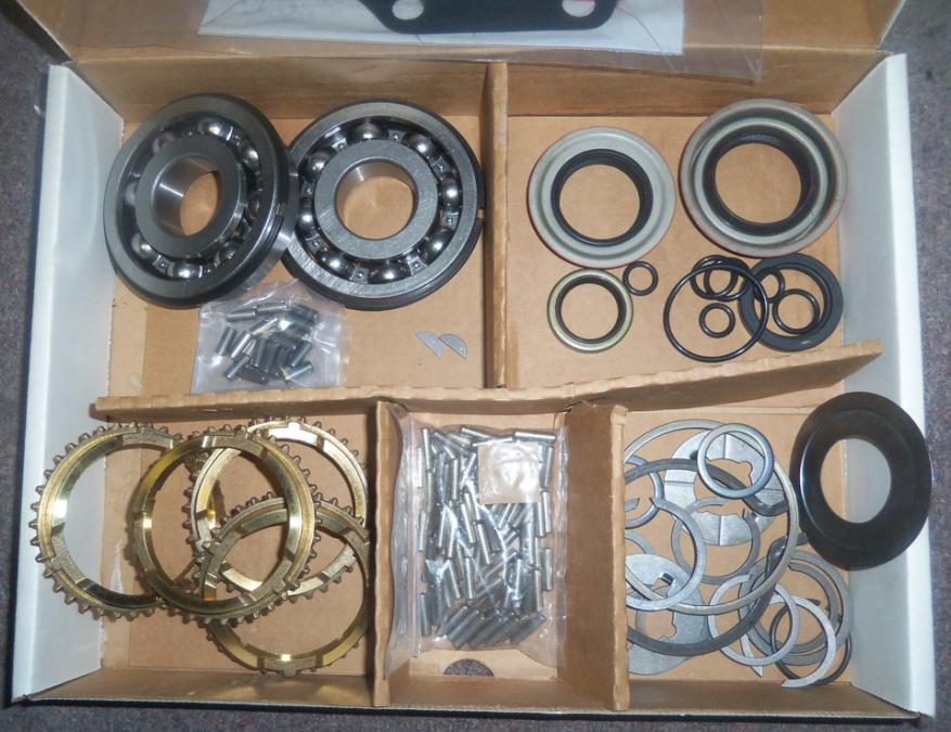

Ahhh looky what came in the mail today. I was sure to wipe all the **** off before I took the pic. Speaking of which, I need to go make Inbowhunter another payment for this thing.

Awesome dude, bet that made your day!! :) Gonna do a write up?

Glad it made it ok!

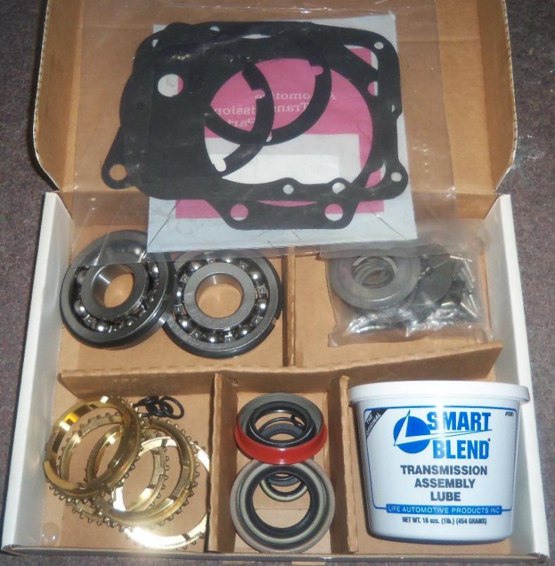

I couldn't resist opening it up to see the small parts.
