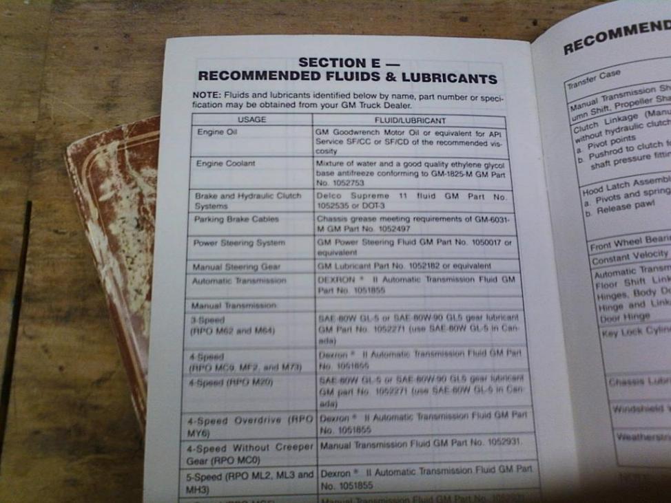

This is an interesting thread/debate on fill oil for this tranny.
http://67-72chevytrucks.com/vboard/showthread.php?t=548664
Seems ATF wins that debate. I'll run ATF and some Lucas oil stabilizer. The old early Dodge transmissions are not OD, the later ones are like in late 80's Dodge trucks. OD gear seems to usually be higher in the case, and sometimes is not submerged in the oil, so if it's not got some kind of oil that will climb the gear, then it can potentially be running dry and cause problems.

Note, Keith Seymores owners manual states Dexron II ATF.
attachment.php
47,859
11,038
Yep, that's what I'll use and Lucas additive since it's an OD trans. I'd have to look at the trans to make sure that is true, but regardless, the Lucas isn't going to hurt.

I"m talking about the 60's cars, the Pre OD Dodges, not the OD Dodges. What fluid did your Dodge require? GM Manual says Dextron 2 ATF.
