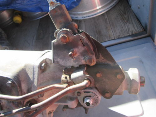

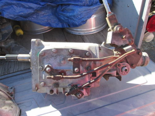

I just picked one up on friday, came with the front shaft, 208 t-case and cross member. Don't have any real plan to use it, but as uncommon as it seems to be I couldn't pass it up for $200.

yep, the shifter is pretty solid right now though. I've been soaking it in PB Blaster since Friday. I'll give it a week of that then start the dis-assembly.

Awesome, yep you really stole it. I paid $80 for mine, but I didn't get the Tcase with it. I got the trans, shifter, crossmember and front driveshaft for 80 dollas. And if you weren't aware, that trans has the same output shaft as a Th400 so it needs the 32 spline Tcase. I got lucky there too.

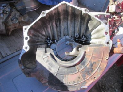

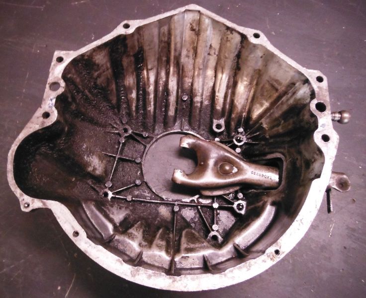

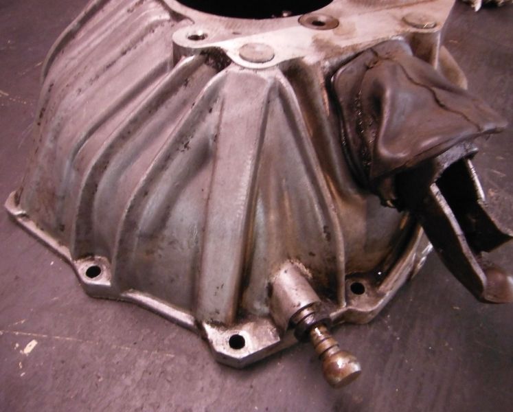

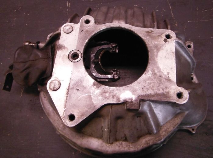

I can't recall, isn't the bell housing the same between this and the m465?
47,813
10,939
No, it's a different pattern on some of the A833's with the offset hole. I think the aluminum one MIGHT be the same as SM465. The later bells are dual pattern. The bell I have came off of an 87 truck with an SM465, but the dual pattern bell would also work with the A833. The Z bar linkage dual pattern bell is pretty damn rare and hard to find. This is the only 2nd one I've seen.

Ok. Good to know. I've got 2 of the hydraulic bells, and one z-bar bell that supposedly came out of an '84 k30
