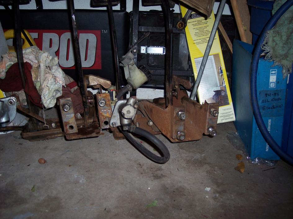

I'm pretty sure '85 was the first year for the hydro clutch. And yeah, the pedals were different and there were two versions. The pedal bracket for vacuum brakes is a little different than the one for Hydroboost. I've been told you can modify one to work with the other, but I don't remember what was involved. If anyone has a pedal assembly for vacuum brakes we can compare and get it figured out.
I'll look tomorrow. I have a set from a Hydroboost truck and a set from a vacuum booster truck.

Took a look at the brackets i have. Seems the studs are missing at the top on the Hydroboost setup and you'll have to bolt it in and the studs are there on the vacuum boost setup and you'd have to remove them to use it with Hydroboost.
