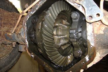

found another one, the guy took a pic with the cover off and sent it to me what do you think

he just called me back its still under the truck but this guy is clueless about it he saids it a 3/4 ton chevy 4x4 pickup with a diesel motor...we are on our own on info on it....pretty good size rear end you ask me kinda big for a 3/4 ton isnt it
47,859
11,038
Yes it's big and it's good. That's a 14b 10.5in Full Float. Break that one, then I'll believe you have some horsepower and 650ft lbs of torque. But, you won't break it. It'll probably hold up to all you can throw at it and that's why wheelers and rock crawlers want them. They are also very common, and only people buying is those who want them for wheeling because it's not people buying one to replace their broken one. They don't break. That's why they are so common. The truck will rust away long before the 14FF goes bad. They may get a bit noisy and get a bit of slop in them and some picky people will rebuild them, but they don't break. I only know of 1 person that broke one and it was very extreme conditions and was probably wore the hell out with some major abuse miles on it.
