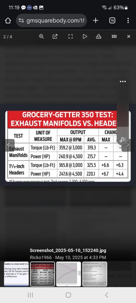

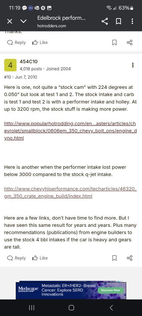

Read Hotrod intake manifold shootout. At your performance level,( stock cam,stock gears,stock heads,stock exhaust)
I think a manifold isn't worth the time,money and effort. Swap it out if and when you have it off do a cam,or heads or after you do gears and other things to up the operating range. GM thought their stuff through pretty good for their intended purposes. You won't even see the 12hp difference with the stock cam. The gains are after 3500 rpms. Their test mule had a small cam.
I think with headers and duals it would be a bit more than 12hp, plus a 25-30 pound weight reduction.
I haven't bought a new intake lately, but when I was a teenager in the mid 70s, that was about $100 well spent.

I wish the links to the manifolds still worked. It's still my opinion that until he makes other changes,such as,gears,heads,or cam. He's not gaining anything in the everyday driver rpm range,the tiny gain with the headers is still a gain and can be used later for more gains.The manifold has to come off to change cam or heads,that would be the time to change it. gears maybe beneficial now and later depending on what he has now. And we have to remember the total budget is 1000.00. I still think best bet is save money do the heads cam and intake at the same time. Remember the manifold you buy now may not work with the heads you choose later.
