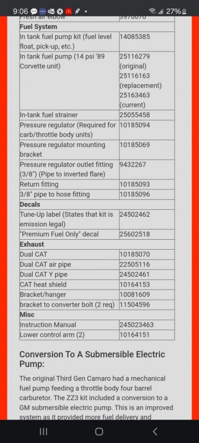

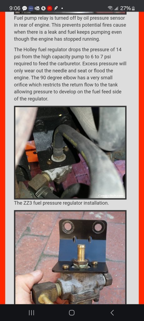

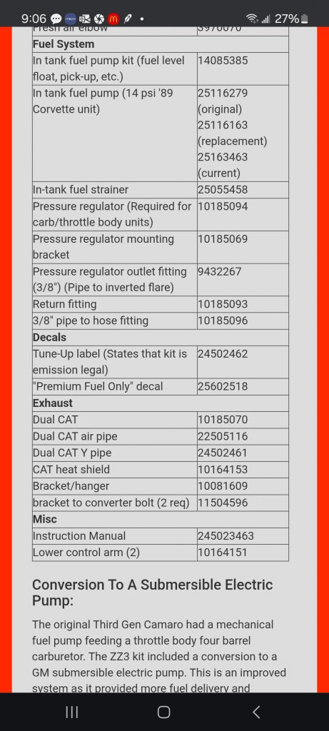

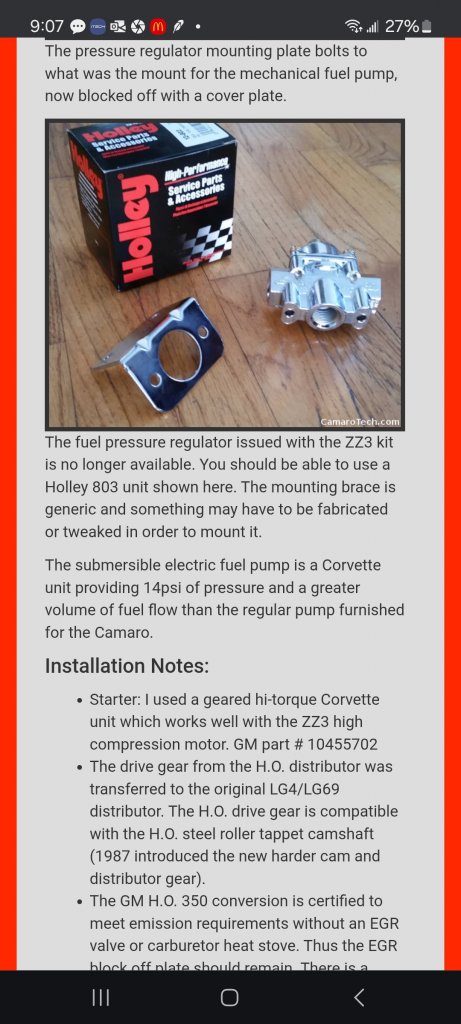

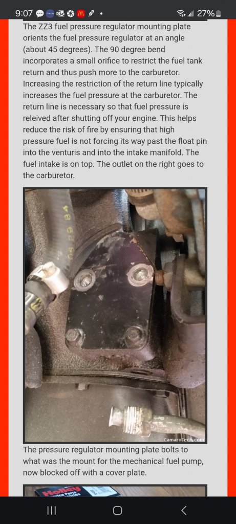

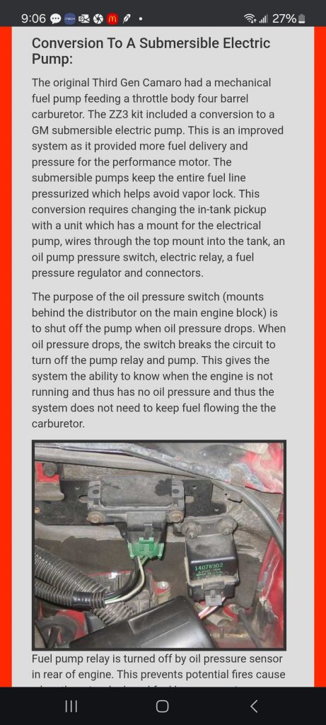

I'm assuming you are doing the vortec swap looking for a power gain. If that is the case swap out the whole engine,going full vortec you'll end up with a roller cam and lifters.A minor in convenience is that your vortec motor 99% is it won't have provisions for a mechanical fuel pump. There are a couple of ways of getting around this. I'd do it factory zz3 style. Which is a tbi pump in the tank a pressure regulator where the stock pump was and uses all factory lines. If you can't find the info.let us know I'll try to find it . Swap water pump,and distributor gear and I don't see any reason you couldn't reuse all your accessories and brackets.
