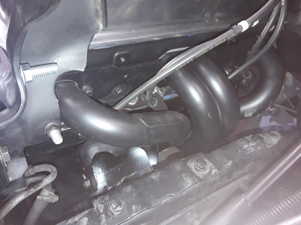

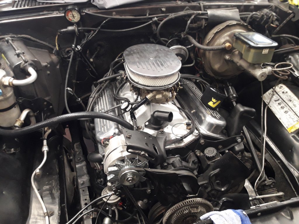

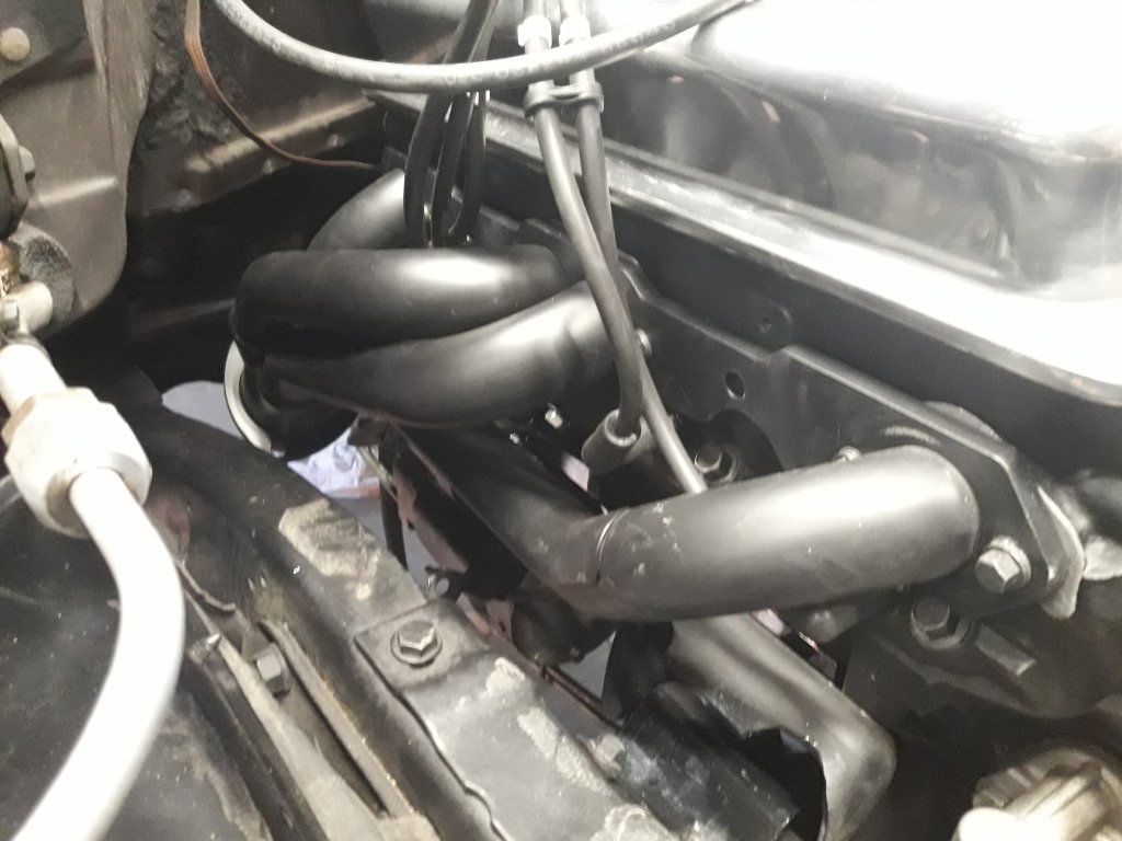

In 2023 a friend and I replaced the stock 305 from his 1984 GM Square-body Shortbox. Same color as yours. We found a freshly rebuild 1980 355 with vortec heads and swapped that in place of the leaky 305. The truck had a TH350 with lock up converter and we chose t o rebuild that and add a higher stall converter instead of going the 700R4 route. We replaced the 2.73:1 rear axle gears with Richmond Gear 3:42:1 Gear Set using Auburn Gear Grip-N-Loc Limited Slip Differential Carrier. The 305 always droned annoyingly on the highway so we founds some really nice sounding Borla mufflers and added them behind the Hedman Standard Duty Black MAXX Ceramic-Metallic Coated Mid-Length Headers. We are very pleased with how it all turned out.
