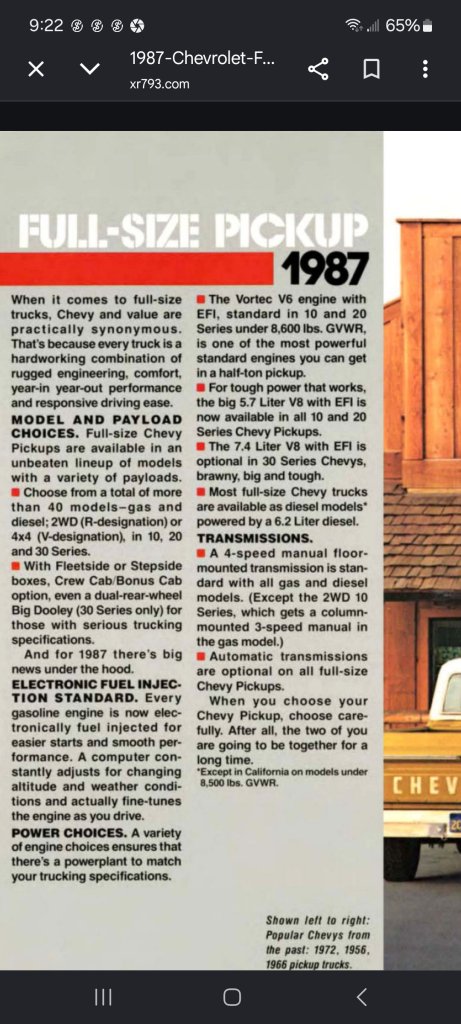

From what I recall, the TBI was not standard in '87. It was optional, but most trucks got it. It may have just been the 305 that was standard with a carb, not the 350. But I don't remember. It might have also just been the early production 87's.
10,186
19,724
I'm pretty sure,sure enough I'd bet money that 99% of 1987 1/2 tons had tbi and all 86s were carbureted. Look up some fuel pumps. BATM I will later. I'm back.
Yes, I'd bet that 99% of them were too. It also may have been a credit option to delete it. I know I've seen a couple small block '87 half tons that were carb. I vividly remember the first one I saw. It was a white C10 longbed, under 100k on it, no rust and straight from Tennessee. My boss at the time had bought it. That's wheen my boss (Owned the junyard I worked at and he loved GM trucks) schooled me on it. This would have been in '02 I believe.
10,186
19,724
Well I sure won't argue the subject, not now that you have that big green badge under your name
