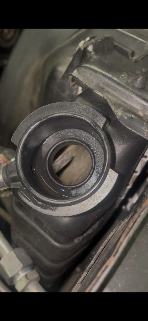

New reverse water pump, reverse fan clutch and reverse fan installed. With front end lifted; using water; no thermostat; upper fan shroud installed and a fan blowing air in the front of radiator, I was still dealing with overheating, however, not as quick. Was able to finish break in. Motor sounds great. Now at idle, still dealing with running hot. Left radiator cap off during idle and tried to burp air out of coolant system as best I can while adding more water. Temp gauge still slowly climbs. After about 15 mins idling, I cut it off at a temp of about 230 (according to gauge). I’m guessing I need a temp gun to verify temp and then regroup.
Will using water instead of coolant and not having a thermostat installed contribute to running hot? I plan to drain and replace water with coolant, but only after I get it running at a decent temp.
Water circulation seems much better.

230 isn't bad and yes, running just straight water at idle can be a problem. Water will boil at 212 degrees at sea level and atmospheric pressure. Every 500ft of elevation above that drops the boiling point of water by 1 degree. Allowing the system to pressurize to the standard 12-16PSI of most systems would raise the boiling point of pure water to 257 degrees F. Mixing 50-50 coolant/water will increase heat transfer and also raise the unpressurized boiling point to 223 degrees, which also brings the pressurized boiling point to 260+ degrees. The reason this matters is that when the coolant goes through it's phase change, it expands greatly and will push out the extra coolant from the system. It also creates little pockets of higher pressure and higher temperatures that will have significantly worse heat transfer properties. The steam will not absorb heat from the engine as well and it will not dump it out of the radiator as well either(if it makes it there).
This is why I will usually test run engines with no thermostat and the heater hose outlet dumping on the ground and the heater hose inlet connected to a garden hose running on full bore. This makes sure colder water is always cycling through the system and it won't overheat during break-in. Then I will run it a bit longer while letting the hose pull distilled water from a jug for about 2-3 gallons to purge the tap water out. Then I shut it off and let it all cool, check torques, etc... Then I will put a thermostat back in, connect the whole system and make sure I have it all topped off and a radiator cap on it before firing it up and letting it run normally to make sure it will come up to temp and thermostat will open and not overheat while also not leaking. Once all that is done, I drain the system again and then fill back up with 50-50 coolant-distilled water and I'm done.

4 degrees ATDC is wild. That will not help at all in most cases. Try moving timing to 4-10 degrees BTDC and it might help a lot.
Yeah, wasn’t expecting that. Adjusted to 10 BTDC and it sounds much better. Temp still climbed to about 215 (guessing on stock gauge) but even slower. I’m gonna get a temp gun to verify.
Appreciate you and Rust on the timing education. Didn’t realize how much that factors in overheating. I guess I was hoping to address overheating then timing. Lesson learned.
