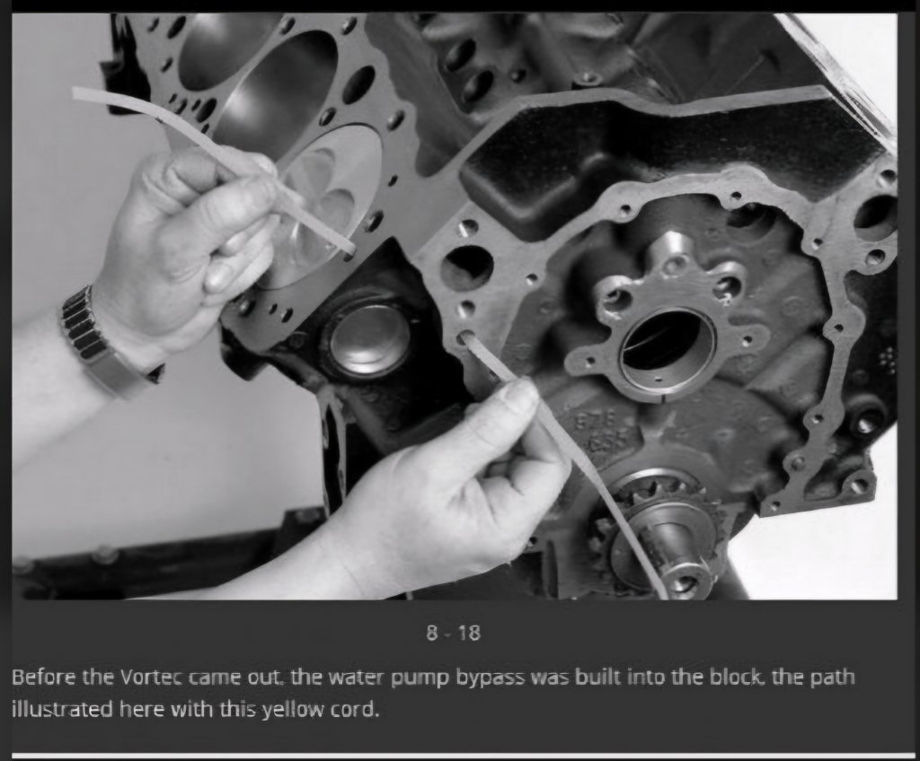

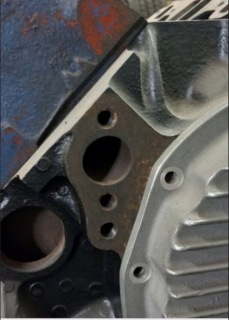

Drill your T Stat holes out to 1/8th inch. What year is the replacement engine block? What year waterpump are you running. Check back I'll put up posts when I find them of the bypass. Is tge heater core hooked up and working? Got you some pics. That 1 hole allows water to circulate until the thermostat opens.Not all blocks are drilled,not all waterpumps are drilled,some people block that passage on purpose,sometimes it just gets plugged with gunk. And sometimes in some situations the heater core itself is the bypass. If you buy a no drilled waterpump they advise you to drill 2 holes in the thermostat. I believe 3/16ths 180 degrees apart. I'd rather sneak up on it to see what I really need. IDK if your bypass is plugged,but the fact that adding bypass holes in the T Stat is making the problem go away makes me think it's a definite possibility.

It’s the original motor, just rebuilt. Heater works like it should. I had the ac bracket and water pump off today and the third hole is open on the passenger side. I’d assume it’s open on the block since it was just rebuilt by a reputable builder.

Did you reuse your original heads? I did locate the predrilled thermostats they use 3x3/16ths holes. I still think I'd use 2 and sneak up on sizes until I had just enough bypass,too much is going to slow warm up in winter. The fact that no Stat = no overheat and a drilled Stat means no overheat still makes me believe it's a bypass problem. Head gasket blocking bypass port,waterpump not drilled or not drilled correctly,head not drilled,etc. If a drilled thermostat fixes it,I wouldn't tear my hair out investigating.
