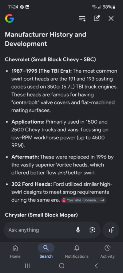

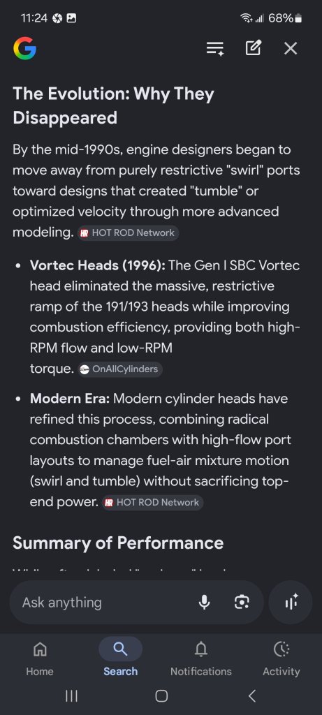

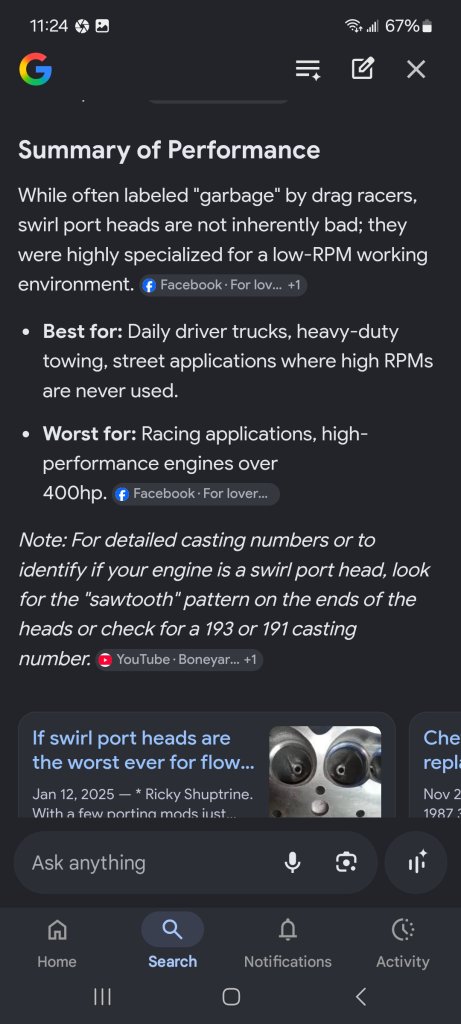

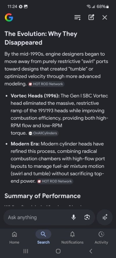

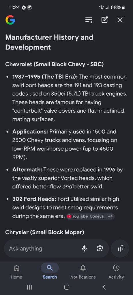

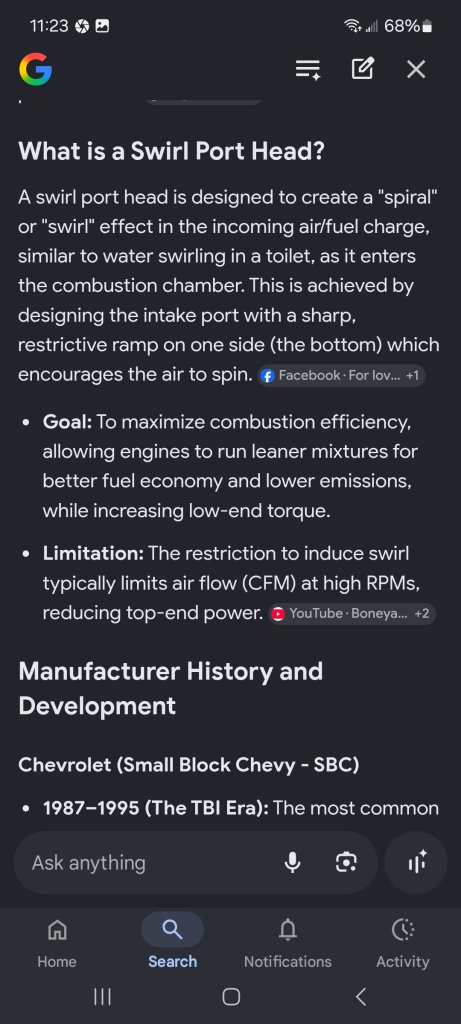

87 would be LO5 engine it's already 9.5 to 1 compression. Everybody bad mouths the 193 heads that are on it. Those heads actually do a real good job under 4500 rpm. They are a primitive fast burn so the make more torque with less timing and get better mpg than 99% of other SBC heads.Those heads will like total timing down in the 28*-32* range. GM used them for a reason,torque down in the rpm range most people drive at and better mpg. Keep your cam small and those heads will work good for a mild build in a budget. Everybody bad mouths them,I like them for a cheap head that does what it's designed to do. I drove to Kansas City to buy a pair from @legopnuematic . The mpg difference between tbibtrucks and carb trucks is not just tHe TBI it's also the heads
