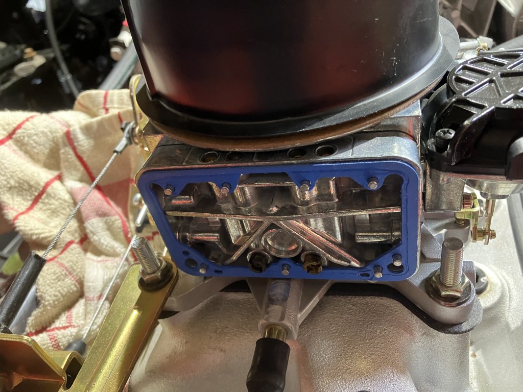

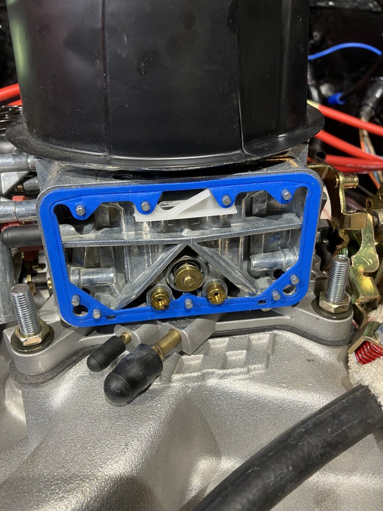

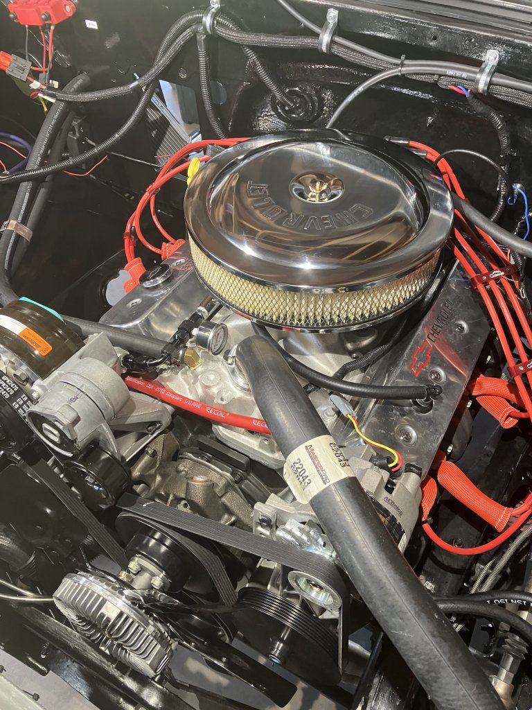

It seems to me that it’s not a timing issue that’s preventing it from starting and running although it still needs to be properly timed once I get the engine to idle consistently. I say this because late yesterday, I decided to pull the plugs for inspection. They were all normal black and dry however I when checked the gap on them I found they were all .045”. I looked at the instructions that came with the crate engine and the spec is .040”. Not sure how or why I originally gapped them at .045”. So, I re-gapped them to the .040” spec. I re-installed the plugs/attempted another start and it fired right up and was running great for the first time. Since I had previously adjusted the idle screw for troubleshooting purposes, it was running at a high rpm so I jumped out of the cab and lowered the rpm to idle speed and it idled smoothly for several minutes with enough time to spray the carb base for vac leaks/none. Thinking my troubles were over I jumped for joy but since it was late, I turned the engine off and planned to restart it this morning assuming it would start/idle again so I could formally adjust the timing and better tune the carb. It failed to start again. Now, I’m thinking that there’s something intermittent that’s causing it to start/run/run good/good throttle response/not start/run bad/backfire/no throttle response/ fail to start/run . When it’s struggling to run, it does not respond to throttle input so I’m now in the process of going through the entire fuel system to see if there’s contaminants/trash that may be intermittently plugging the fuel system. Keep in mind, that I have restored nearly everything with new hoses, filters, pump, etc. I inspected the RobbMC inline 40 micron fuel filter b/w the pump and carb- clean. I pulled/inspected the Holley carb filters-clean. I pulled the float bowls-clean. Interestingly, the primary has a brass float, the secondary has a plastic (phenolic) float. I did notice orange silicone (or rubber plug?) in one of the accelerator pump orifices in the primary float bowl (see pics). Is this normal? If not, could that explain why the engine doesn’t respond the throttle input. I think the orange plug is supposed to be there because its shape is perfect. Any other recommendations before I put the carb back together and continue my fuel system inspection all the way to the tank/filter sock? The tank sender unit isn’t working either so I’ll have to check it out. Thanks again for sticking with me through this!

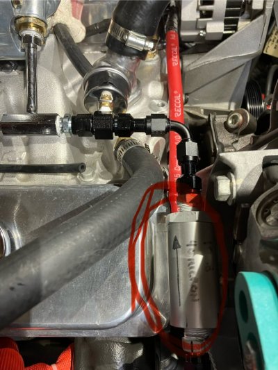

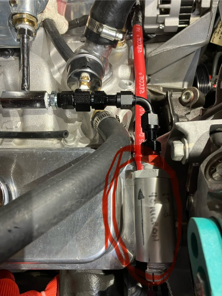

Additionally, for T/S purposes, I removed the RobbMC 40 micron filter element between the RobbMC mechanical fuel pump to make sure that it wasn’t causing a fuel flow restriction but still have the Holley carb filters in place. See pic.
key thing here warm vs cold, how its primed, and did you set the choke or did you just try cranking.
The fuel needs to stay primed , see through filter would help see this, if this is issue, youd need to crank a bit to get fuel to the carb, then two pedal pushes but not to the floor, then set the choke, then crank
If your fast idle setting is off youre not gonna idle well either but if its untouched it should be at worse high
but you may have adjusted the high idle low if you were in the high idle cam when you were idling the day before

Yes sir, I corrected the PCV with a PCV specific hose and moved it to the drivers side. I also removed the breather from the front passenger side and installed an oil filler cap and installed the breather in the rear passenger side cover just like the diagram you provided. I also adjusted the timing by using a vacuum gauge to reach its highest 16” of vacuum by advancing the distributor, then retarded it down to about 14” at 800 rpm however, it is still backfiring (although much less). It still has an off-idle stumble and dieseling (run on) after I shut the engine off so in thinking it is running lean and hot, I rechecked and raised the float bowl fuel level by turning the screw CCW to raise the fuel level a little higher in the bowl to where it just spills out with gentle rocking. The fuel level was a little too low before. But, when I attempted another engine run is when I noticed the upper radiator hose was severely swelling up from what I think was a stuck closed T-stat and is why I made a separate post for that issue that you saw and commented on. Hopefully, the new Robert Shaw FlowKooler T-stat that I ordered but won’t get until next week will stop the overheating and dieseling. Then, I’ll have to keep troubleshooting the off-idle stumble and backfiring. Thanks again for your help and the help from everyone else.

I cant tell for certain but your hose to the PCV still looks like its Fuel line, the EPA compliant with green text you had used before. While this isnt something that will affect your operation like your current woes, its a long term thing that needs correction, you need something that has SAE J30R7 on thew hose printing , if it says J30R7 youre okay, usually it will be labled PCV/Emission Control or Fuel Return hose
