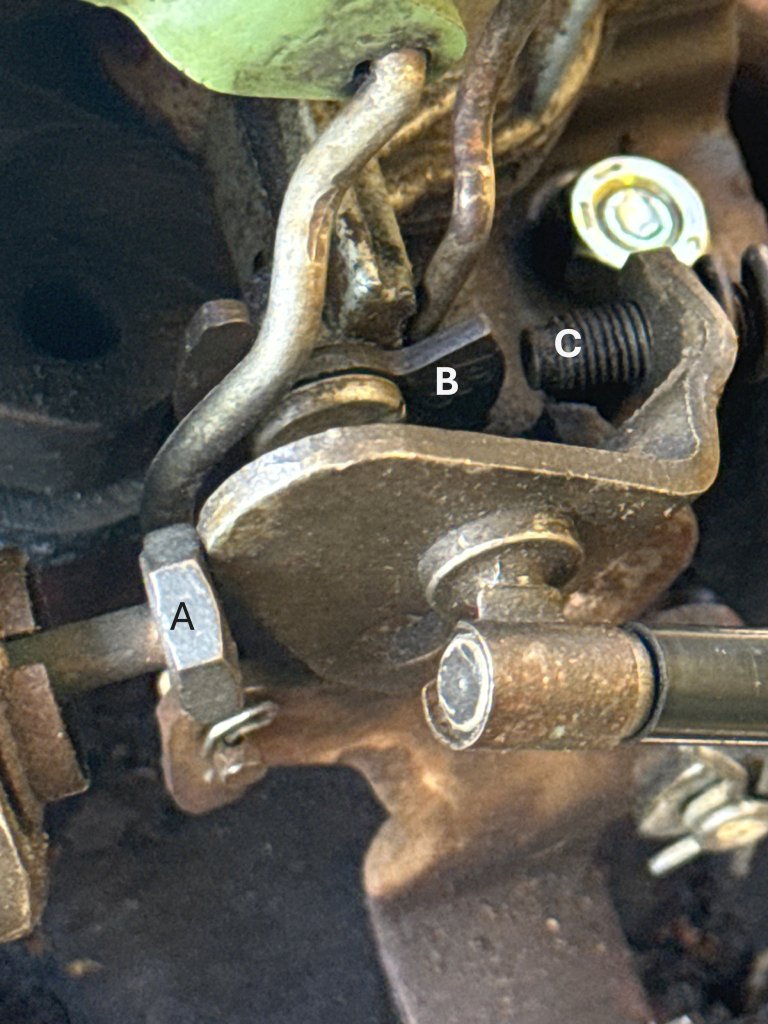

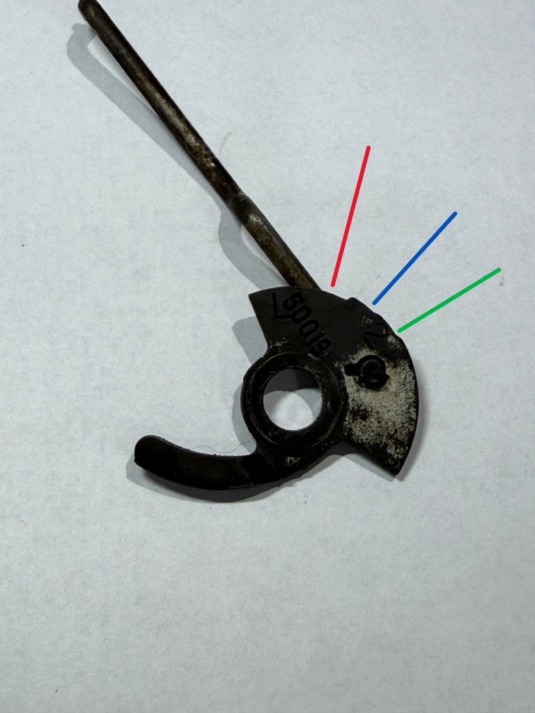

I think I'm getting close, but the fast idle screw adjustment has me completely baffled. The instructions for the Rochester 2GV are not terribly clear and nothing I find on YouTube (even from Mike's) shows how to set my particular setup. I'm convinced I am missing something super basic but cannot see it.
Engine is warm, choke is open.
My limited understanding is the solenoid (A in picture below) opens throttle plates as it warms up. When the choke fully opens the cam (B) rotates clockwise. And I think the idle set screw (C) is suppoed to catch the cam at one of the steps. But if I tighten that screw, the pressure keeps the cam from moving at all. What am I missing?
Any recommendations on videos or websites I need to search?
