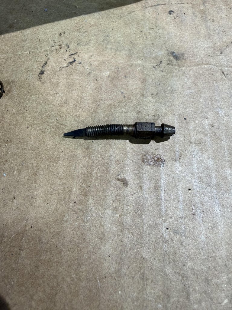

Probably wouldn't hurt to get both, probably be the same in shipping, and then both are new
