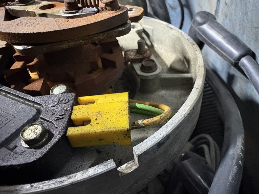

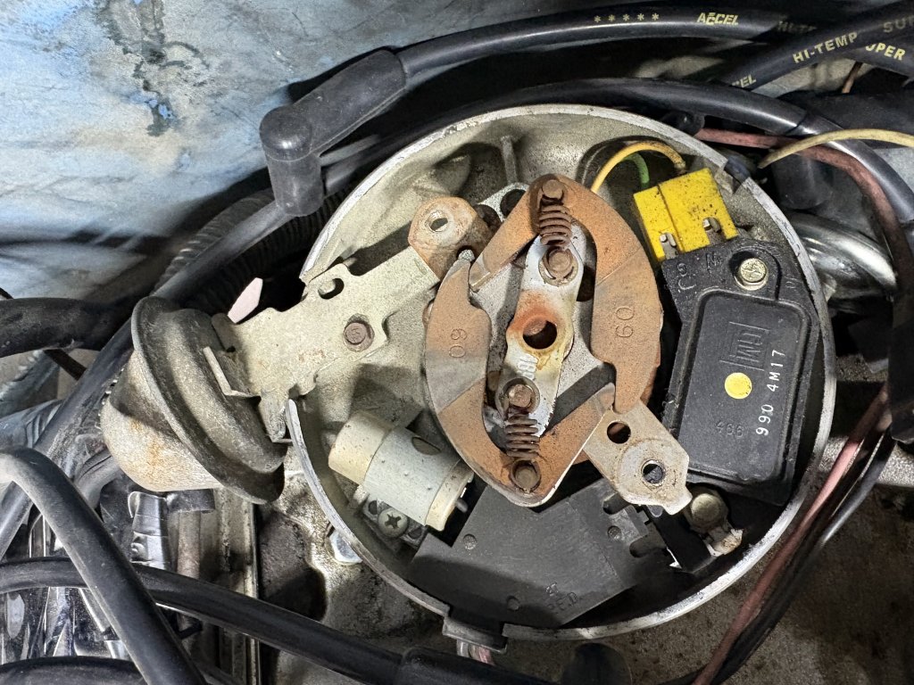

Where the 2 wires attach to the pickup coil they can break right at pickup coil. Cause is from the advance plate moving. I sometimes give them a gentle tug with a needle nose pliers. if about to break it is usually visible.

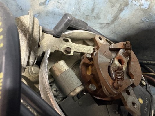

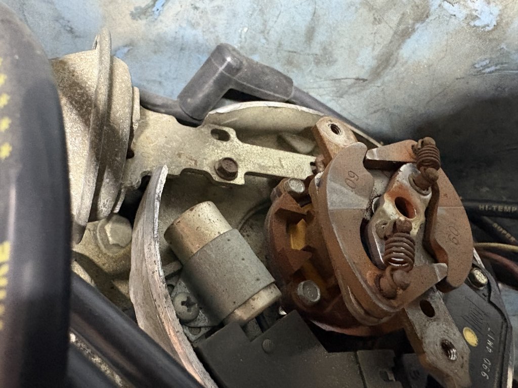

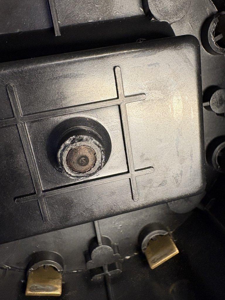

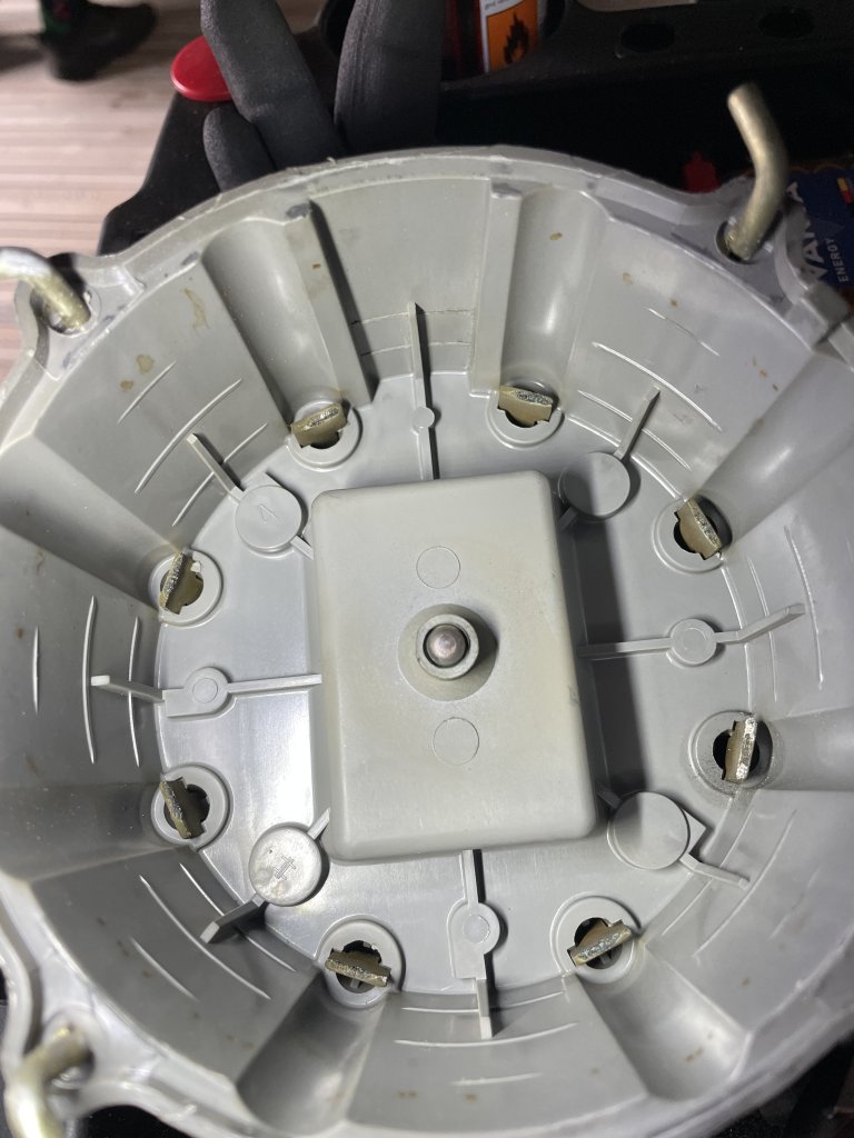

Pulled the cap again. Attached some pictures. Not sure if anything obvious is visible? Wires seem good.

Your cap is wasted

Your cap is wasted
My thoughts when I saw it. I first thought it was bad molding from the factory. But maybe not so?
This is my old AC delco cap which went bad about a year ago. It does not have the same grooves around the carbon piece.
