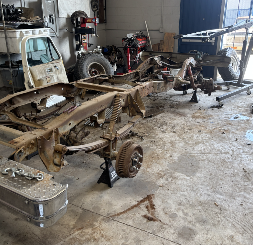

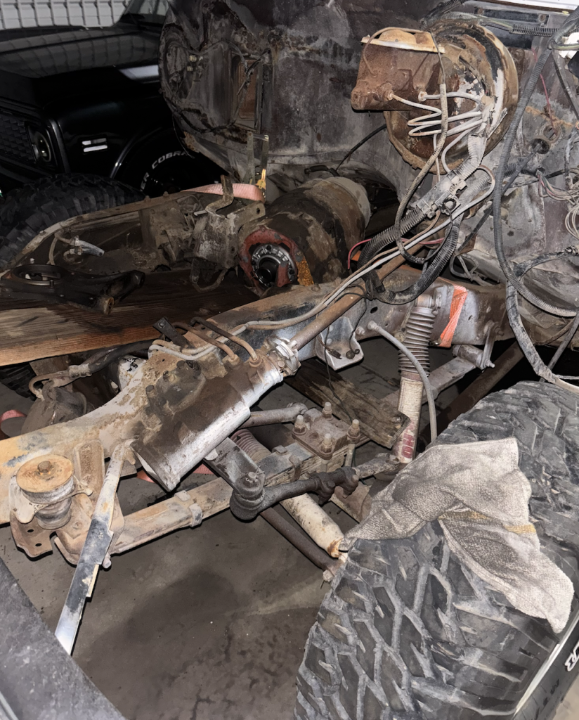

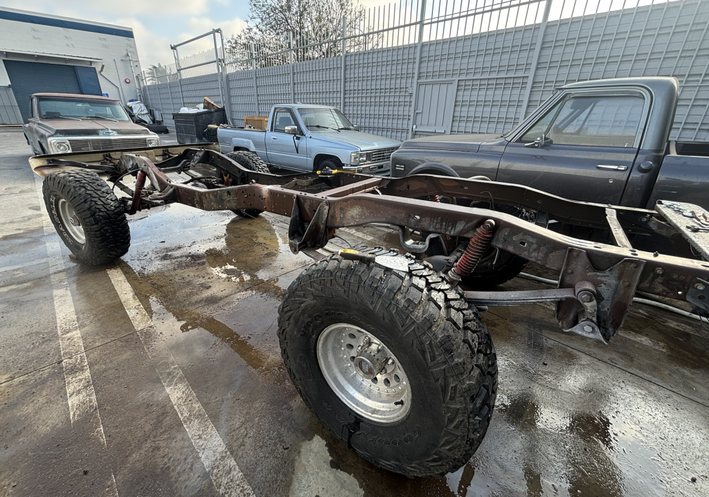

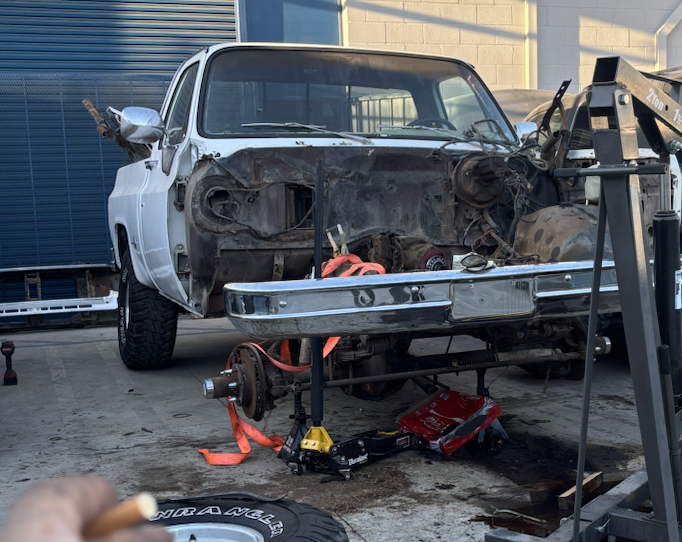

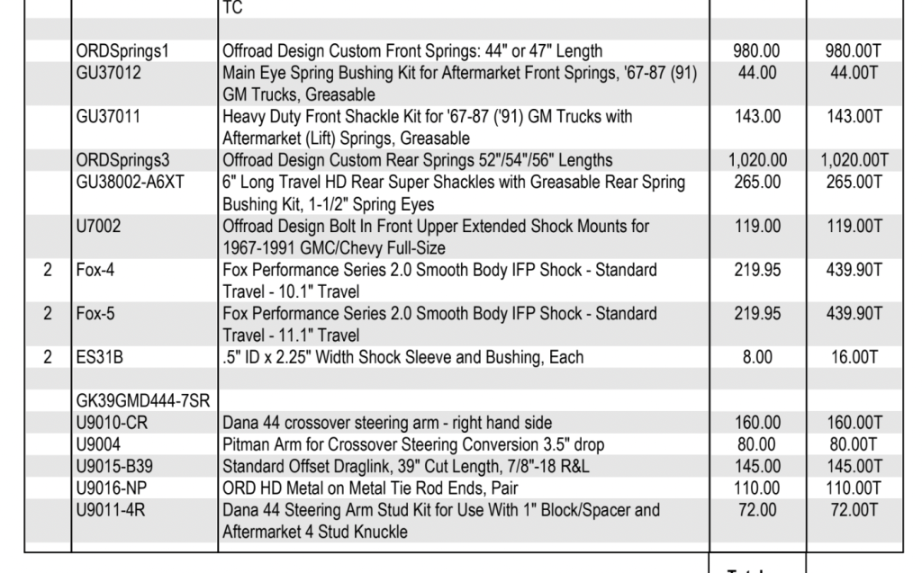

hey bucket i am in the middle of contact with them, they have sent me 2 quotes so far, the first one i requested just the best possible ride quality with my desired lift, it came out to around 6000$ shipped. i guess i just wasnt expecting it to come out to that much. i requested a more budget friendly option without compromising ride quality to hell and they sent me back another quote for around 4000$ shipped which is far more realistic for my purposes. i am waiting to hop on the phone with Tanner over at ORD who has been beyond helpful and patient with working with my lack of overall knowledge of 4wd suspension. i will attach pictures of what i have on my phone as far as pictures of the existing set up. i will also attach the more budget friendly quote and the other more expensive quote if it might be helpful for someone in the future or for consideration if anyone has any other sort of advice or anything to add

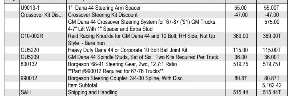

the "budget friendly" quote

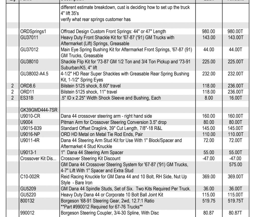

the "best possible ride quality" quote
Yeah, so that's not at all comparable to a lift kit. That's all the components you would get with a kit, plus every other part of the suspension and steering. And it's all upgraded too.

Get rid of the crossover steering, and applicable parts and that will cut your cost in half if not more.
Especially since you're street driving it, don't need crossover steering. I would splurge on the leaf springs and upgrades surrounding them. Shackle hangers, bushings, shocks, maybe spring hangers.
I daily a stock steering, 4 inch suspension lift on 35's and wheel a little bit. If i upgraded anything steering it would just be heavier tie rod setup and steering box.
35,422
44,726
I agree about the crossover steering. On a truck used mostly on the road, you'll never notice a difference. Some people will say otherwise, but that's my experience with it.
Now with that said, if you were going to be fully rebuilding the steering system and using a high end steering box anyway, then crossover steering is one of those "might as well" type things.

How much lift is currently on it, I would assume it has at least 4" already to be on 35's?
You say blocks, does it only have lift blocks in the rear?
IMHO, so long as nothing is broken, there are not lift blocks on the front or any other known issues, I would just run it with the existing lift. There's nothing wrong with 4" blocks on the rear for a "mall crawler," and cross over steering isn't really needed at 4" either. I'm on the same set of 3.5" re-arched factory springs and lift blocks I installed in 1997 and still with factory geometry steering.
Spend your money on ball joints, tie rod ends, drag link ends, drop pitman arm, ORD Steering box brace, wheel bearings, axle U-Joints, new bushings (bonded rubber will ride nicer than the popular poly stuff), a pretty set of shocks, brakes, Etc.
If money is burning a hole in your pocket I hear the ORD springs are nice but I have no personal experience with them. I believe they can build springs with a spring rate to match the driving type.

As HMFIC at ORD, thanks for the recommendation and feedback on our help. Tanner is relatively new here and is great. He's a square guy for a long time with a K5 and a crew himself.
Couple notes:
1: with decent HP levels (and it's hard to NOT make good HP with any GEN3/4 swap) spring wrap will likely be a problem so rear blocks become more of a liability. In fact, it's often a good idea to run a traction bar setup with any leaf spring and it's typically more necessary with our custom stuff.
2: with our custom springs, crossover steering is probably more noticible since the bump and roll steer in the factory stetup gets worse when the suspension moves more. That said, even with custom springs, you can definitely drive the truck with corrected stock steering and it can be a large price add so it's a good place to cut cost now even if you plan on it in the future. No matter what, crossover will give you a tighter turning radius with how dramatic the change is
3: Shocks are another place you can drop some cost if you need to. Gas monotubes are nice and durable but about double cost of a typical white body and the real gains in ride quality are in the spring, not as much in the shock. So if good ride is your priority, get the custom springs but drop crossover and put some whitebodies on it.
4: The ride difference between our custom springs and a typical lift kit spring is not minor. When we let people ride or drive in our trucks they're usually shocked it can be that good. Especially on lighter trucks.
5: there's a broad range of personal preference in all of this. Some guys may not put much value on a softer ride. Some guys may tolerate steering quirks/problems better than others. Ask a question about running without a swaybar and you'll see a lot of opinions on that as an example.
