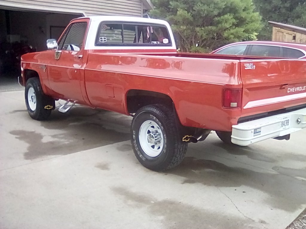

Redfish your post inspired me. I went from a rough riding 4” superlift to your setup. I didn’t want to mess with the front springs so I went with 2.5” rear blocks.
Now I need to get a new steering gear and power steering pump - probably a Borgeson shaft without rag joint….

@danzey your truck looks good. You have a lot of potential there. What are you going to do about a front bumper?

I’ve got a brand new premium bumper from LMC. Remaining items I’m working on is all new borgeson steering gear and shaft with new PS pump, bumper, and probably will remove a leaf from front springs to get a bit of rake as well.

Update:
front springs ended up settling a bit without removing a leaf - and now I would say this is dead level - 40" to fender well front and back.

I see a bit of rake. If thats a concern, an easy fix might be the Monroe coil overs on the front. I've got them on a stock k10 (front/rear) and it leveled it out. Worth a shot for under $100 for the front shocks. 'Course you'll have to measure for correct length since you lifted it.
I've got the set front and rear and it's level to my eye with 32" tires

It has more rake now. Both @danzey and myself prefer a bit of rake. I actually wish my truck had a bit more rake than it does.
