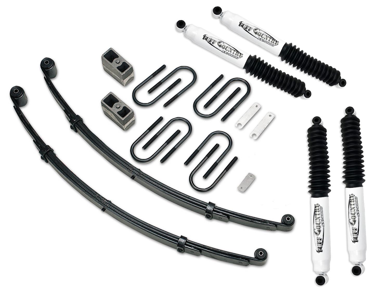

This is 2.5 inch Tuff Country spring lift both front and rear on 33/12.50. It has not rubbed or scrapped the front tires so far. My daily is a Tacoma and Pro Master van, I want to say that the ride is too soft with this kit.

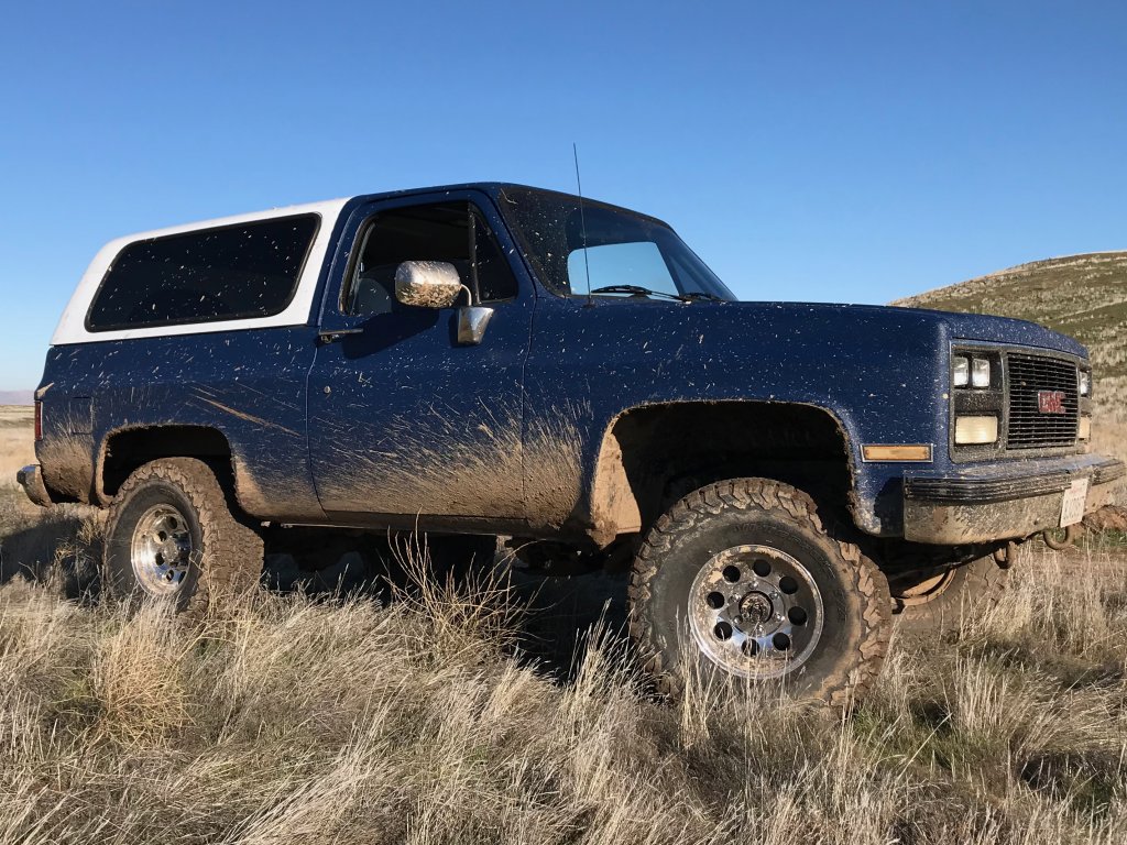

Not exactly what you're asking for, but figured show for fun since I'm also debating a new lift. Mine has what I assume is a 90s Skyjacker 4". Had 15s with some baby Big O tires; gap was horrendous. Filled it with 35s on 17s. I'm looking to replace the lift eventually with something that won't send me to the poor house. Hit a stick in the road and it sends me to the roof.
