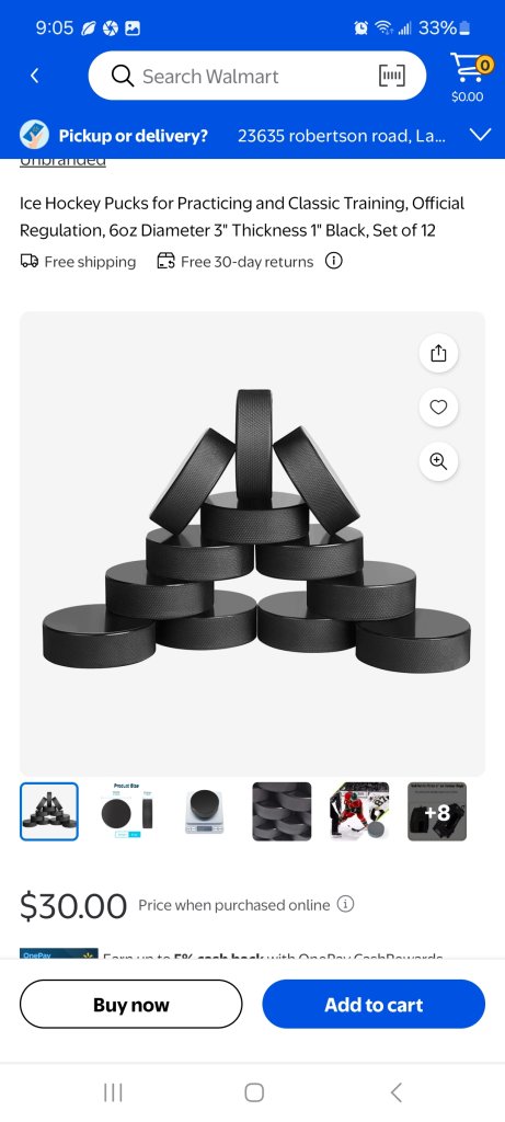

Oh believe me, I have.
Hold my beer while I post these pics. This is far dumber than a body lift. :oops:
The cat is parting this puppy out. I spied these works of art while they were unbolting the roll bar.
