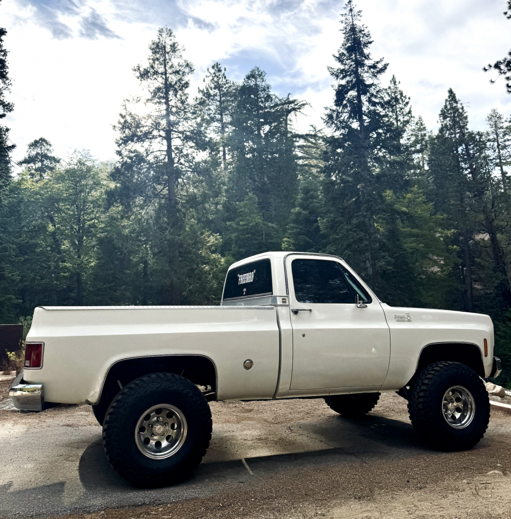

Thanks for the info. Luckily the body lift went pretty smooth and visually you can hardly tell. I relocated the bumpers so that also made a massive difference. My truck already didn't have a fan shroud on it so I haven't had any cooling issues after about 300 miles put on it thankfully. I run Water Wetter in the truck and also in my 67 Camaro that definitely makes a difference on the 100 degree days out here.

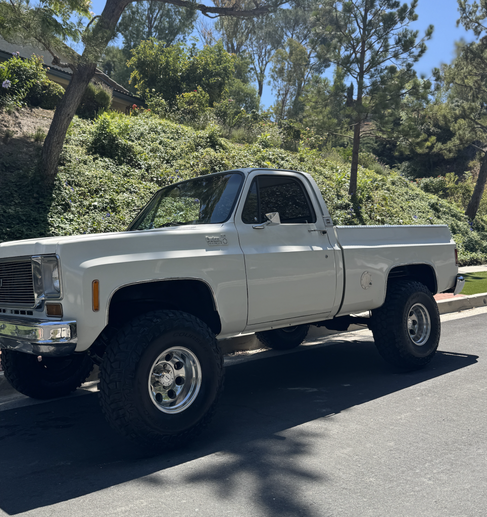

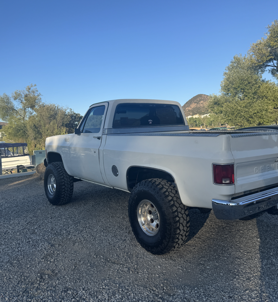

Thanks for all the suggestions you guys helped a lot and here is a pic after.
