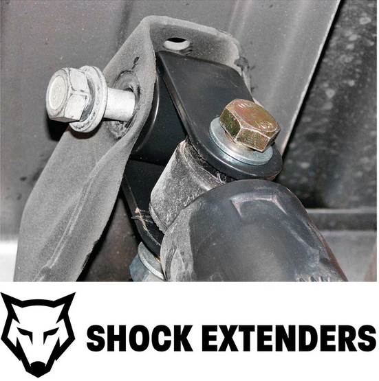

I want to lift my 87 K5 3”. Can I just go with a 3” tapered steel block front and rear? Obviously would need longer u bolts and shocks as well. Where can I get extended shocks?
I was looking at rough country 4” lift which comes with spring packs. My spring packs are good. I also read reviews and found some saying it lifts the front by 6”. It also doesnt include hardware. That is a lot of money for an incomplete kit that you further have to mess with to make correct. 4-6” is more lift than i am looking for anyway. Any thoughts?
