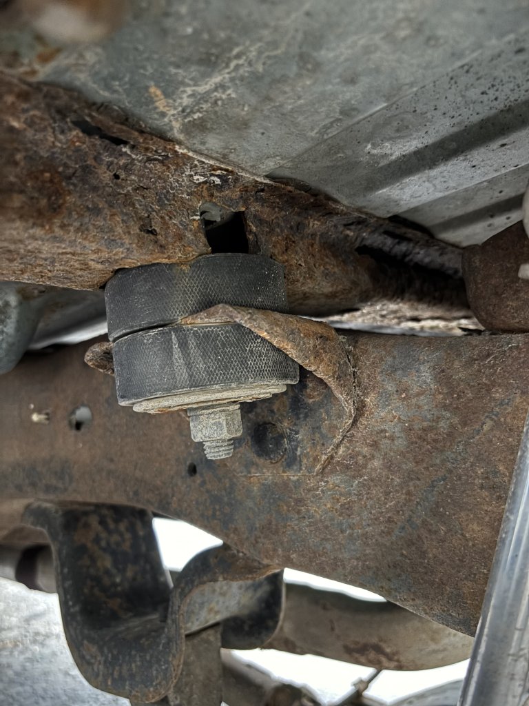

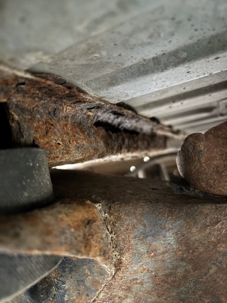

I’ve been looking everywhere and can’t find this crossmember for sale anywhere. I have to assume 99% of parts trucks it would look about the same as mine. Anyone know if anyone makes this?

I'm unaware of any being repopped. Burbs tend not to get the same love as pickups and K5's. Sectioning down some pickup bed crossmembers might be the easiest solution.

I could be mistaken, but I seem to remember reading the pick up crossmembers wouldn’t work for some reason. I just had a lightbulb idea about getting some square tubing and drilling holes for the body mounts. Don’t really see why that wouldn’t work.

They won't work as-is. That's why I said to section them. Slice them down the length of both sides, overlap the sides to reduce the height, then plug weld it all back together.

The square tube will work, but only comes in 1/4" increments. It would also be more difficult to weld to the floor pan.

This is the best option, even if it's labor intensive. It'll have the best end result
