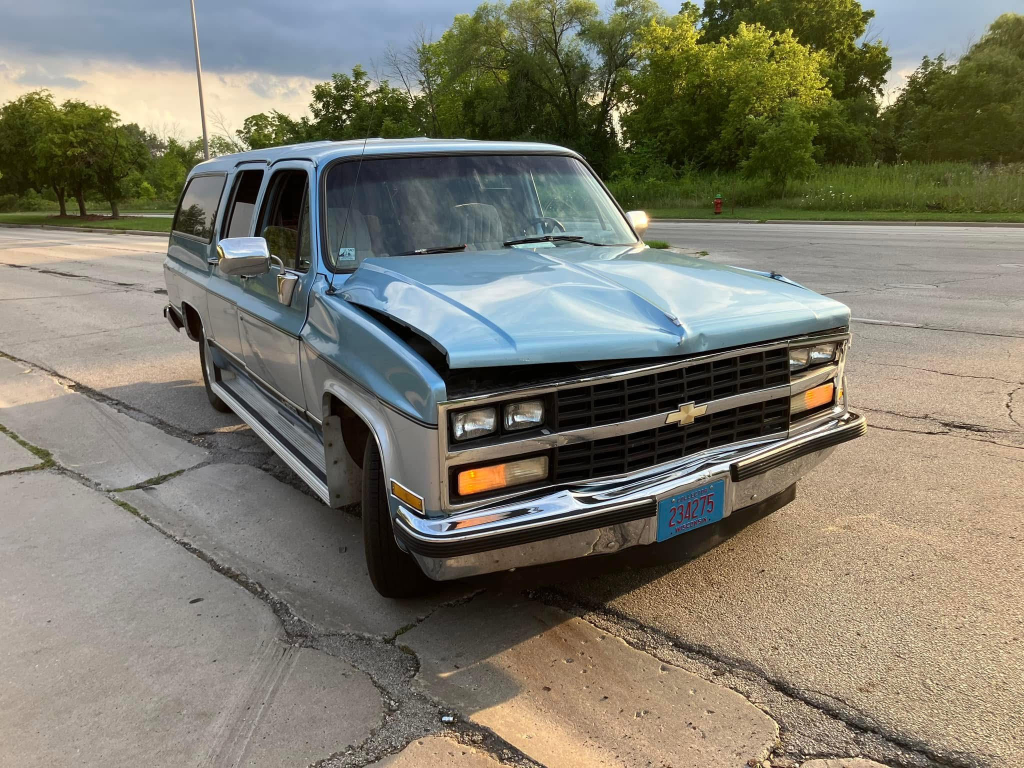

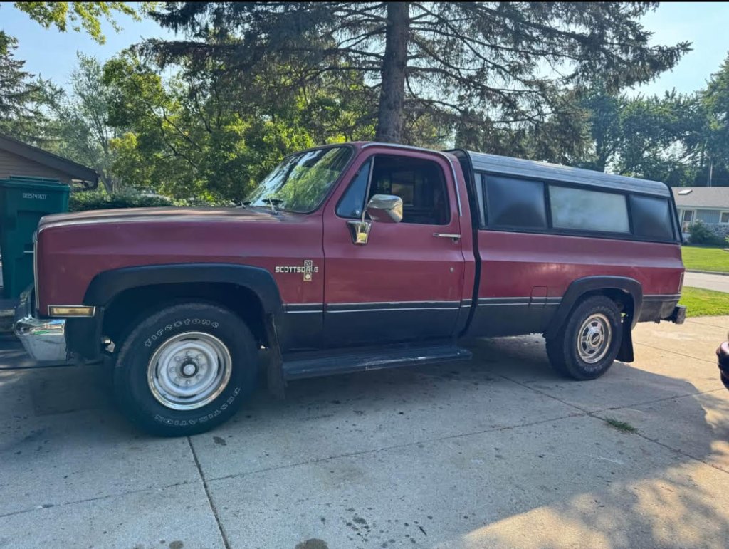

Hi All,
I'm in the process of trying to find a donor truck to frame swap my '89 suburban classic body onto. I found a '83 Scottsdale roller that claims to have a frame and core support in good condition. Does anyone know definitively if these frames would be interchangeable?
Thanks in advance!

They are not interchangeable directly. I'm sure with enough work you could make it happen but not a simple swap.

Truck frames have a different wheelbase and the rear frame rails are contoured differently than Suburban.
I'd fix that wrecked frame LONG before doing a frame swap. Not a doubt in my mind.
