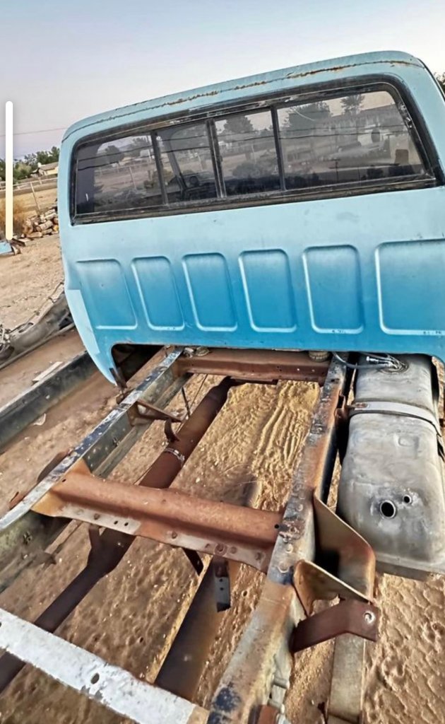

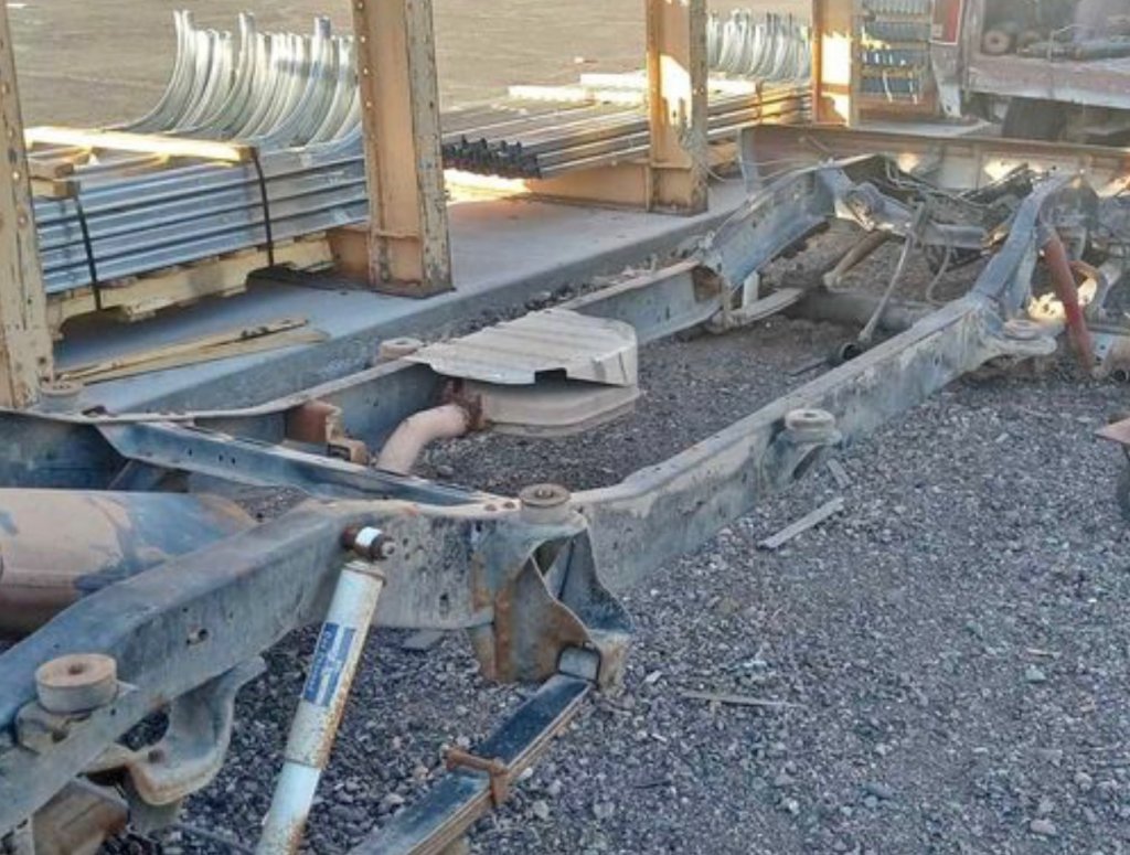

the sub has a WB of 129.5" as you said, the crew cab long bed has a WB of 164.5, best i can figure is the Crew Cab Shortbed is 150.5". That is taking the CCLB WB and subtracting the 14" from the frame length as people do when shortening a CCLB. So my idea stems from wanting to use the Sub's 1/2 ton f/r suspension, the TBI 350/700R4 trans, the steering column, the rear mounted fuel tank and the brake system as well as the entire interior, doors, and the front clip. Seems more straightforward to swap the bodies vs all the drivetrain and all i mentioned above. Either direction i go the frame needs to be either shortened or lengthened. As long as the fab work is done right and properly reinforced, it seems thats a better way for me to go with less chance of f'n everything up as the sub is a running driving vehicle where 95% of everything works. Anyway thats my plan. I might even sell the 89 Crew Cab 2500 and just buy a bare crew cab body then i don't have as much to part out or scrap when i'm done. I'll only have a suburban shell to get rid of. The pics show the rear body mounts on the truck cab are inboard mounted on a crossmember. The other pic is a sub chassis where the body mounts are outboard of the frame rail. There is a long straight section of frame on the sub frame pic where it could be easily stretched under the cab and the rear body mount crossmember added.

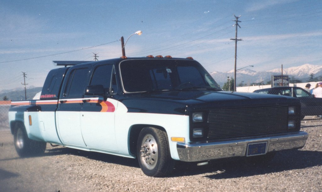

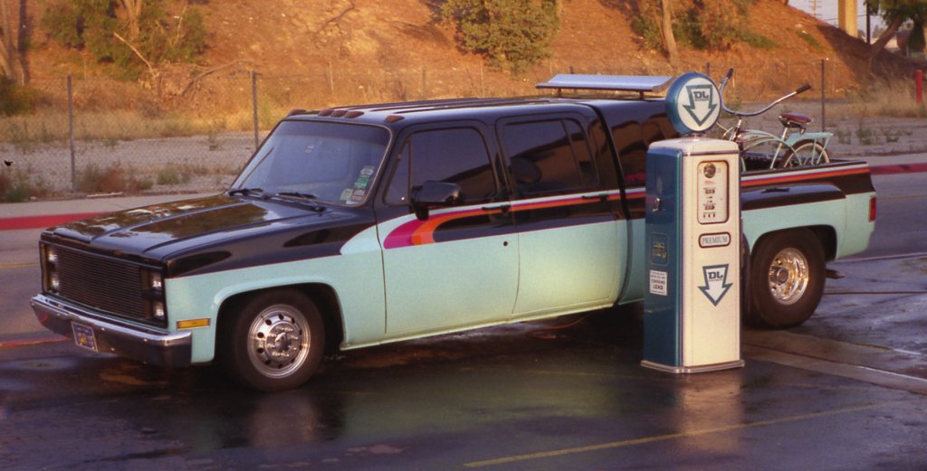

I'm actually stoked as i haven't had a squarebody for a number of years. I had a pristine 1991 Sub that was unfortunately stolen and a semi custom 81 Dually in the pic. It had a 15"x15" Weld super single with a big M/T 18-31.5 /15 tire on it so i'm not totally new to this.
