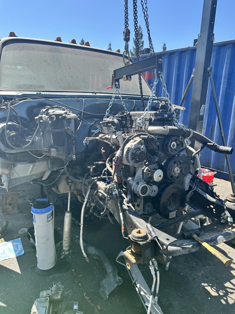

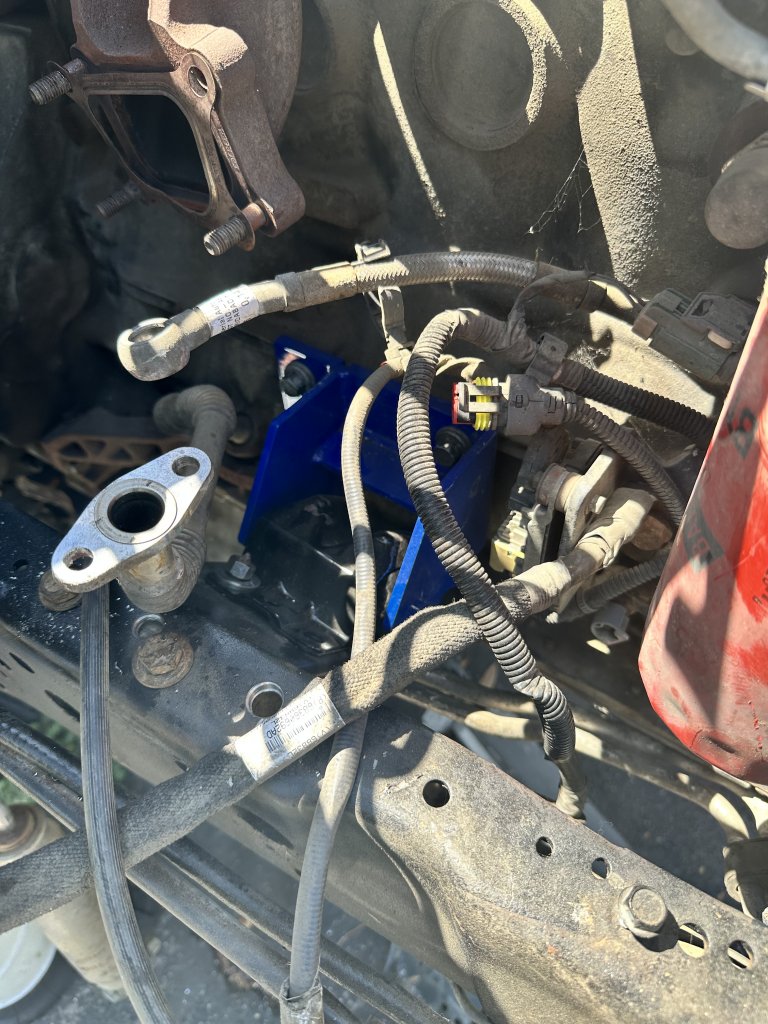

Hey guys new to the forum and currently under way of a 6.7 crew cab. Have a complete pullout of a 2019 ram 2500. 6.7/68rfe and bw 44-47. Have a superduty axle for it with hogback fab mounts here are some pictures of the current progress. I have reworked the stock harness and can turn on the engine, accelerator pedal working and working obd2 connection. Have the stock axle removed and 6.7 sort of sitting in place still need to move the engine back a bit. Not my first swap also have a 72 K20 with a 12valve 4l80 combo but it is my first try at a commonrail swap.

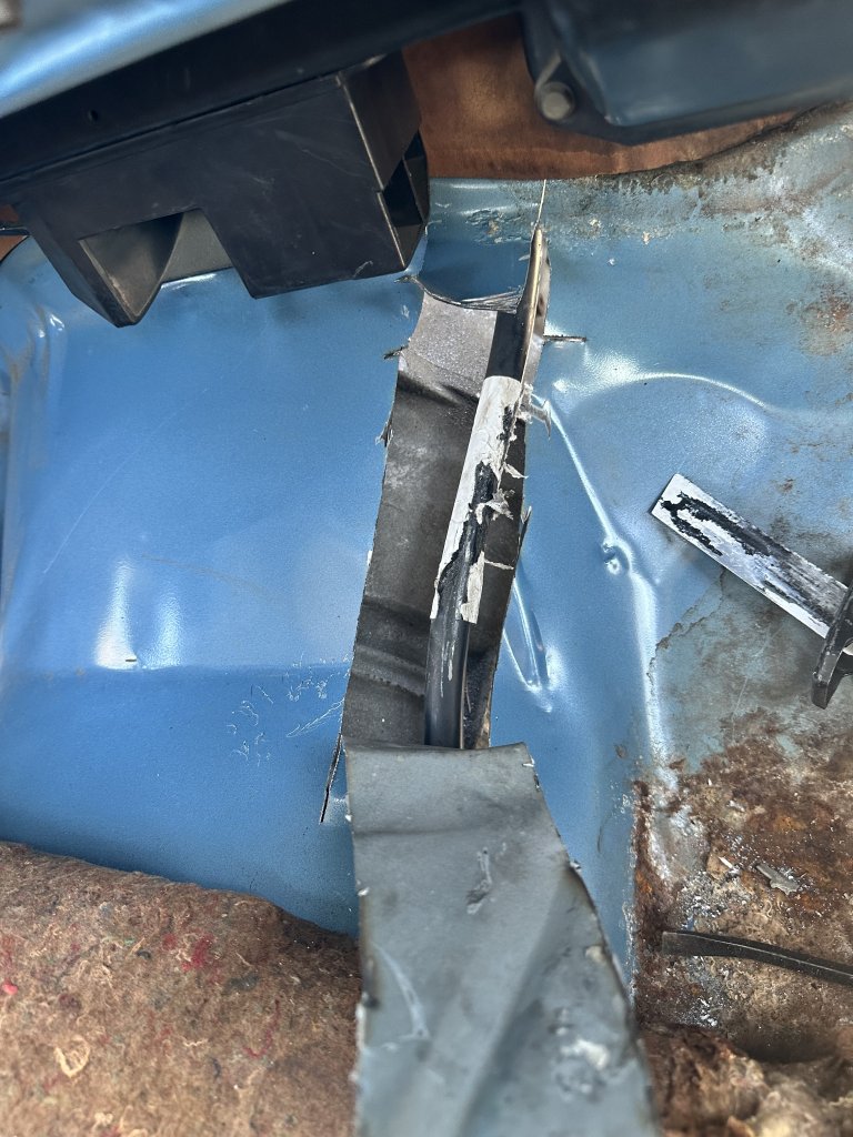

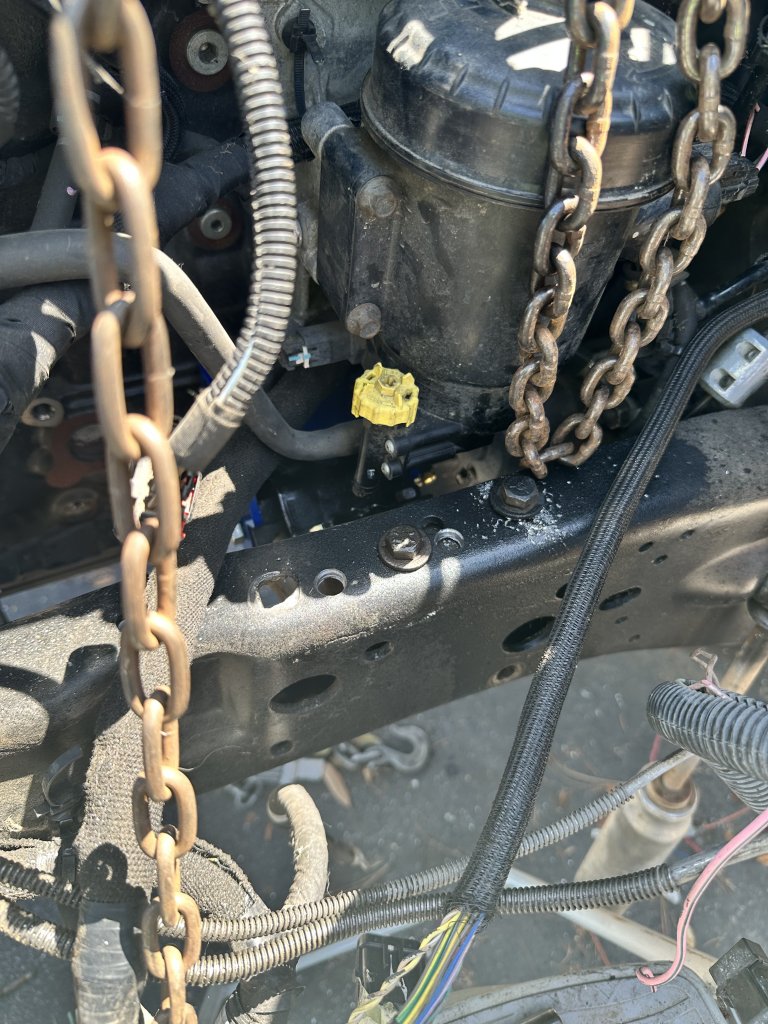

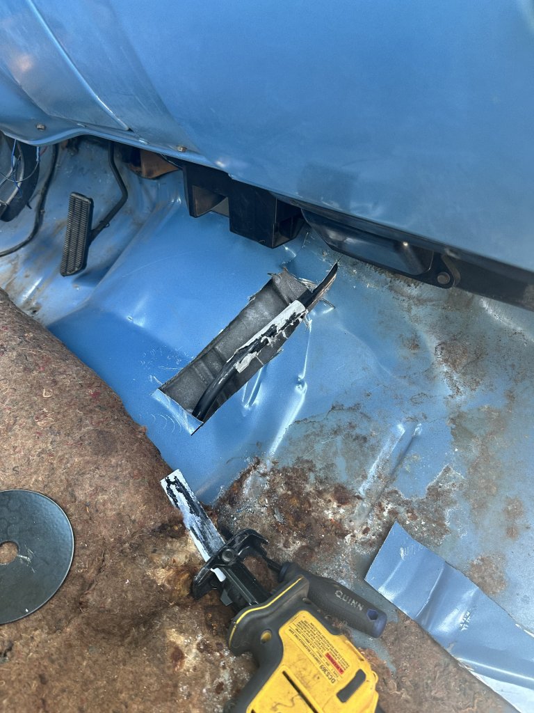

Well got some more progress going didnt take good pictures of the transmount or engine mounts but pushed the engine as far back as possible and started the process of installing the superduty 60 front axle.
I had to cut the transtunnel a small amount to get the dipstick to fit but not much. In the current spot i have the engine placed the turbo fits in stock location with the factory Ac box and all. So far have almost everything figured out just need to make time to finish it up HAPPY FRIDAY FOLKS
