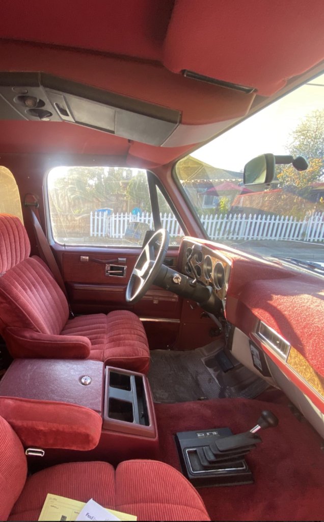

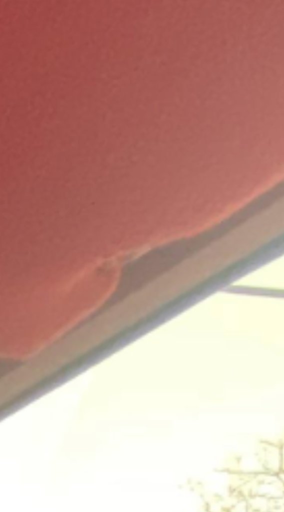

@HotWheelsBurban
Not pics of the 91 suburban I’m getting the visors off of, Im an hour away and the guy that has it isn’t home either but here’s a couple pics of a 1991 interior I found online. The second shot is a closeup of the clip area. Also including a eBay link to a set of these late visors with the clips,
Plenty of pics of them on there.

The appear to be aftermarket conversion, unless GM changed it up in overtime in the squarebody game.
Can’t say for sure, but if they mount the same then they’d obviously work.
I don’t believe they’re aftermarket. I’ve seen these before in 1990-1991 Suburbans and not conversion suburbans either. It’s just that I haven’t found a set until now that’s in good enough condition to just swap in without having to figure out how to recover them in headliner material. I think you’re right about it though that if they’re coming off a 1991 Suburban now there shouldn’t be any problem with putting them in my truck except drilling the holes for the little clips to hold the other end and then wiring the lighted mirror up. I’m going to grab a couple of the above the door grab handles out of it to eventually swap in my truck as well but I already know that’s going to be some work since they bolt on with recessed nuts welded in. I’m ALSO going to get the aluminum door sill trim it’s got and use the front pieces from the front doors and rear pieces from the rear doors to make a set of aluminum door sill plates for my truck as well. Silverado is the luxury truck so IMHO it ought to have all those goodies just like the late Suburbans and Blazers.
