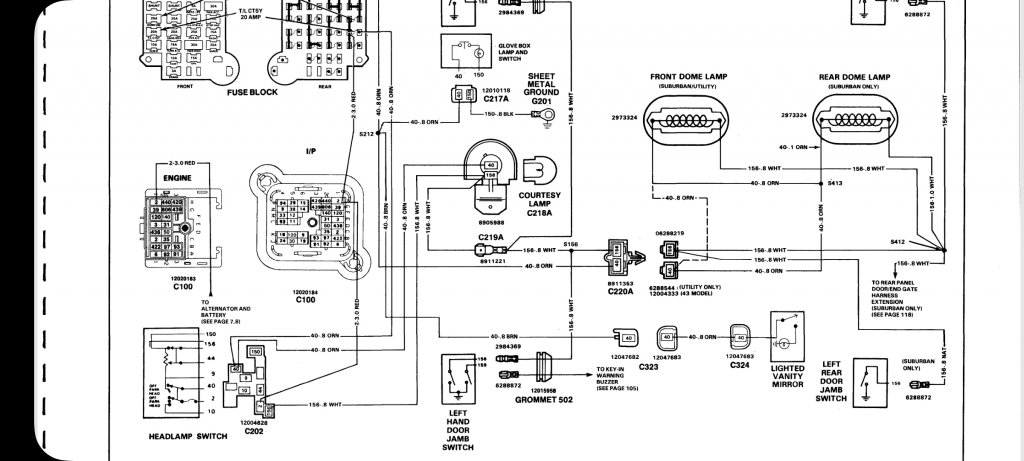

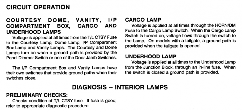

yes, tail light/courtesy fuse is the one for the dome/glovebox/vanity/etc. one of those wires in the vanity should be hot all the time at the vanity. the other one must to go a ground. check for 12v to find the hot one. check the other one to see if it is grounded. if it isn't it should be. the schematic doesn't show where it is grounded, so it is probably someplace close by the visor mount i'd guess. but I've never torn into it to know for sure.

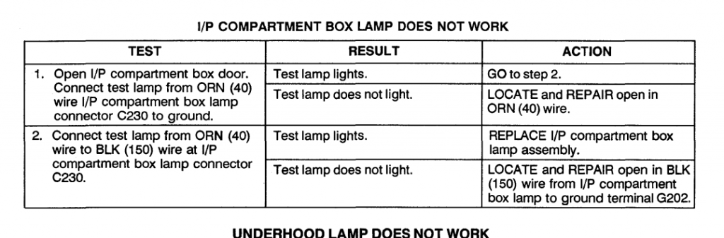

It is grounded through the vanity light switch. Could be a bad switch or bad ground if you have power on the orange wire. I attached the diagnostic for box lamp- vanity light should be similar. i couldn't find one for the vanity light. like mentioned before- not exactly sure where the vanity light grounds.

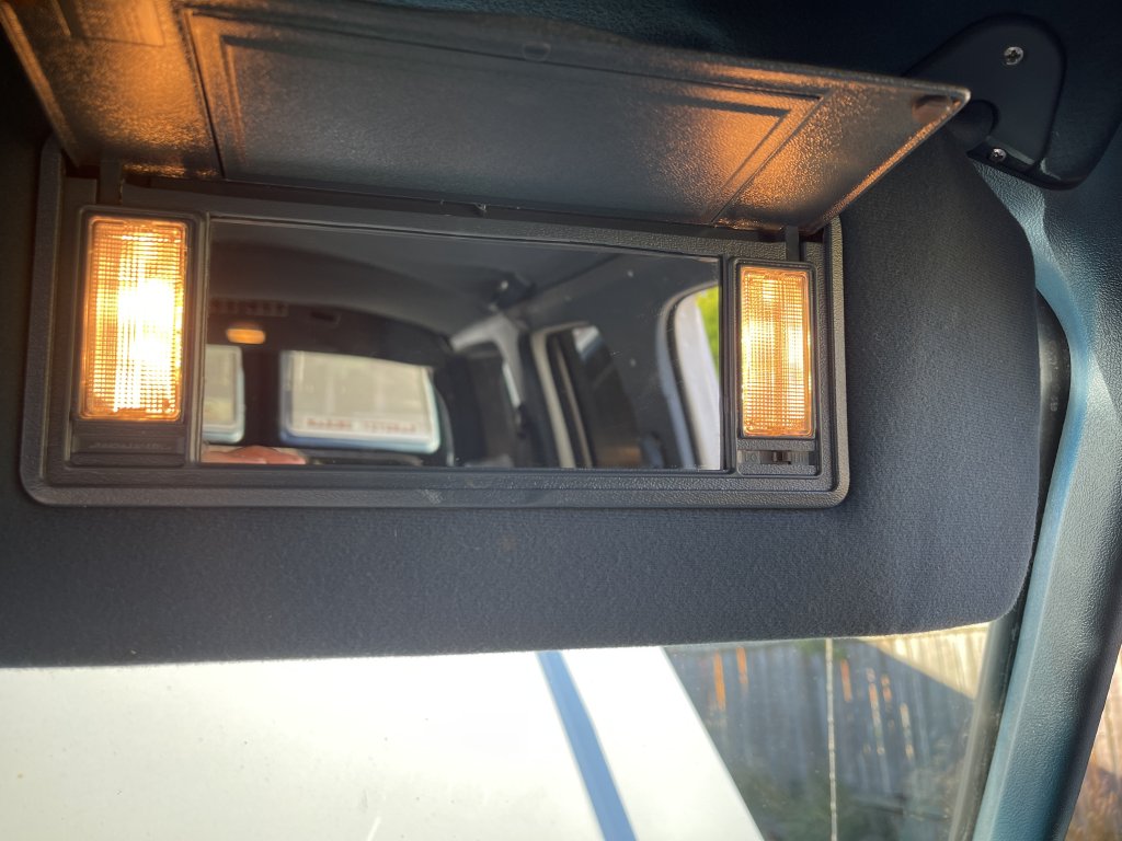

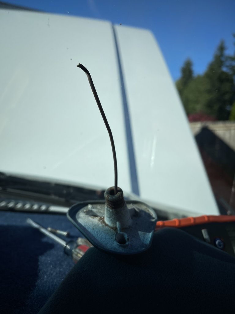

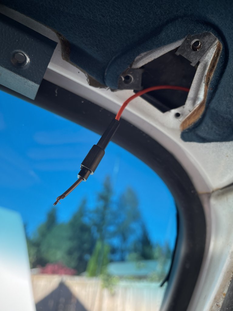

reluctantly I decided to take the visor off and do some poking around. I was hesitant to do that because though the headliner looks pretty good but the foam backing disintegrates just by touching it and the corner of the headliner where the visor mounts was my concern. The wife knows we need a new headliner but that's not in the budget right now and even though she reeeally wants the lighted vanity to work she's agreed to let me hold off and deal with it next spring... she's an awesome wife in so many ways, always supportive. Well, her awesomeness inspired me and when she headed out to do some grocery shopping today I thought what the heck, be careful and see if I can see what's up...
turns out the wire that runs up the pillar was broken!!
I was so lucky in that there was enough wire on both ends I was able to solder it and bada-boom-bada-bing! its working!! :cool:
